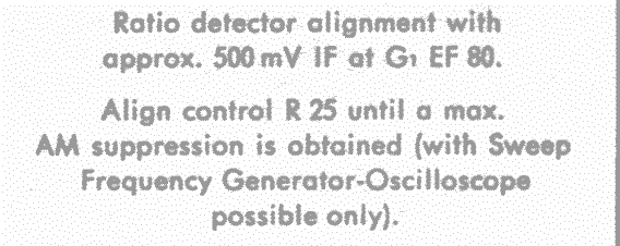

Reply  |  You aren't logged in. (Guest)   12   Hello Paul,
 The questions: There is an adjustment R32 rheostat (a two wire variable resistor in a network with R30, C62 and C63) on one of the plates of the EAA91 tube.   With an oscilloscope on the plate the voltage responds to the signal strength as the tuner passes transmissions.
What is the function of this adjustment and how should it be adjusted properly
my answer: this trimmer R32, adjust and brings, the AM-Rejection to an maximum.  AM- Rejection makes a supression of amplidute modulated (unwanted) signals.
This function is the primary performance of the Ratio -Detector invented from Stuart Wm. Seely and Jack Avins from RCA Labs.
To adjust this function the equipment must have an high standard.
In 1958 GRUNDIG brings this simple message:  " Alignment can be done with Scope only" Thats a little bit naivety i think.
Two yeahrs later, " Allign control R...  until a max. AM supression is obtained ( with Sweep Frequency Generator_ oscilloscope possible only)
No further informations.
My comment: since nobody can nows what Equipment is on Workbench,  no one will give advice with that Paper.  Maybe after align,  its  worse, then bevor.
Now my advice to you:
1. Inject an AM -Modulated Signal of 10,7 Mcs on G1 ECH81, the signal strengt should be for 4 to 6 Volts DC on C56 10uF Ratio Electrolyt. Adjust R 32 for minimum audible Mod. Frequency ( 400 to 1000 C/s) depents from your SG.
2. Or very simple, but good ( i to that offten) receive a weak FM Signal from Air, select one noisy signal (with much noise in background) Adjust R32 for minimum audible noise. Thats all! This procedure can used for all Sets Tube or Solid State. (Transistor  with an Ratio)
For your better understanding, i spend an original picture with text, from an RCA Print  ( Seely, Avins)   There you can see, what is shows on an Sweeper_Scope Equipment. Only as PDF ( to much bits)
So Paul, i hoppe is all clear?
Best regards
Hans

Reply  |  You aren't logged in. (Guest)   13
Hans,
I used both of your methods for adjusting R32 below:
With the assistance of a good eye tube and a decent ear, Methode 1 was the best for me and the avaiable FM "Noisy" stations.  The control dipped quite easily and I was able to determin a minimum adjustment point rapidly.
