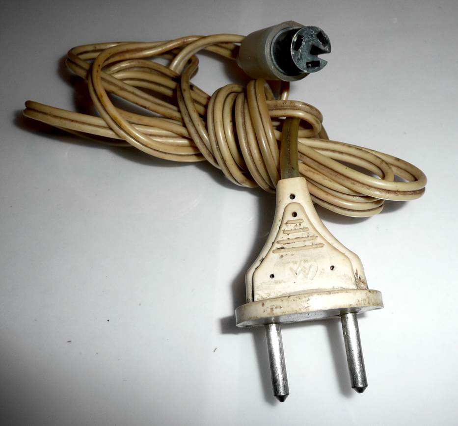

A visitor of our site has a Selena radio and is missing the mains cable.
Does anyone have a cable that would fit the radio ?
If no, what kind of connector is it and where to find it ?
What is the connection scheme of the connector ?
Thank you in advance in the name of our visitor.
Vincent
Attachments:- Mains connection Selena (38 KB)
Cable found but attention ! Danger !
27.Jul.12 10:05
105 from 5199
One of our member (Jari) has found the cable for the Selena radio and has been able to help his other colleague.
Unfortunately I need to post a warning from Jari for whomever is interested to connect such radio on the mains power:
My experiencies with Selena 212B radio, made in USSR is telling me to not use the power supply build inside.
All radios imported to Finland had vax sealant on the mains connector. Electrical insulations on transformer and over connection of 220 AC mains area are not properly done for safe use, can results in dangerous situation.
So maybe it is better to operate with batteries only with Selena radios.
Attached is a picture of the mains cable for reference
Attachments:- Mains Cable Selena (61 KB)
