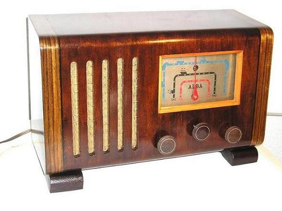

I've here one British Alba 472 in restoring process. As you can see, the cabinet is damaged. It is unglued and wormy, so I had to replace some wood. Fortunately that task is over. I'll show you the results in my next article.
But, some parts are missing. I had to invent the two feet based in an old prospect image.
But the picture is so dark that I couldn't see its knobs.
Well, the problem are the knobs (three buttons).
Do you now how those buttons are like?
Thank You for your attention
Regards
Mário Coelho

Restored with buttons
17.May.06 21:22
Mario Coelho (P)
Articles: 451
Count of Thanks: 11
Mario Coelho
Thank you John, Thank you Mike,
This Forum is much more precious after your so interesting contributions.
Here it my restored set:
After regarding the two types of buttons in the pictures which you sent to me I think those buttons (above) which I found in my "Noah's ark"  may be more or less of the same pattern in that photo sent by William . Do you agree?
Best Regards
Mário  Coelho

Mario,
congratulations! superb job you've done there, and the knobs look
ideal; I don't think it really matters whether they're absolutely
original as long as they look as if they were intended for the set,
and I think they do.
I suppose this is part of what the museum is all about.
My thanks to Mike Izycky for finding me the circuit for my Bush EU24.
Very pleasing all round!
                                       Regards, John.

Dear Mario,
What an excellent job you've made of this radio! Truly excellent. The knobs do look very much like those in William's picture, and they look as though they should be with this radio.
Regards,
Mike.
