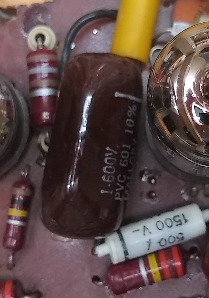

The Mallory caps are not obiously paper caps, but, like the Neokons, could be.  Attached is a photo of one of the Mallory caps in the set.  There are only 3 in the set so they are easy enough to replace if it makes sense to.
Thanks again for your help.
Mark

i think the caps on your last pic are plastic film caps and ok !
many greetings, Michael
