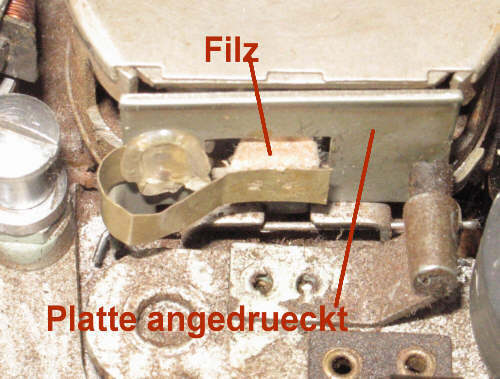

![]() Hello! I have a problem with the record/play head shield plate in the front of the head. It does not open when recorder is not in play-mode. It seems as a missing spring of some kind...? Can anybody give me a tip how it should works? See picture down here! Thanks /Lennart Schander |

Hallo Mr. Schander,
an der Platte vor dem Tonkopf fehlt ein Federblech aus Messing mit Filz. (siehe Bilder)
Viel Erfolg bei der Reparatur
