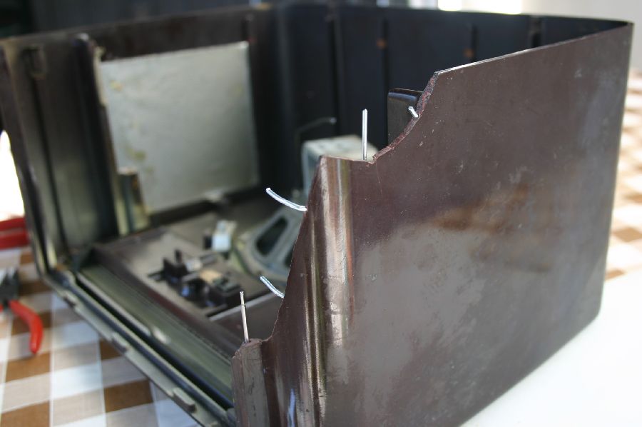

               State in that it was the broken cabinet.
Fig.2
MY METHOD OF REPAIRING
First I have drilled a thin section of the broken area to fix pins in order to improve strength to the fiberglass’s filling up. Afterwards, I have cleaned deeply whole the broken area with cellulose diluents in order to clean up any grass and dirtiness.
Fig.3
             Two pins have to be bended according to the cabinet curvature.

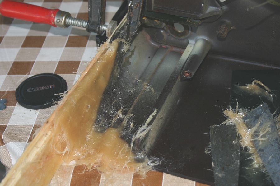

After the cardboard was well fixed, it was bended according to the cabinet shape. Then I have fixed from the outside a wooden lath with the aid of some staples in order to hold the cardboard in its position. The fiberglass weight could change the cardboard curvature, (see fig.6). The gloss face of the cardboard was previously greased with virgin Vaseline, so the fiberglass doesn't cling to the cardboard.
Fig.6
Then I have kneaded, according to the manufacturer's instructions, an amount of fiberglass (enough to cover the Bakelite lack area with). I have applied it with the aid of two spatulas and I’ve let it dry very well, (read the manufacturer's fiber appliance instructions about the time of cure and about handling). Warning: to work in one ventilated place.
Fig.7
After it has very well dry, I have pulled out the fiber in excess from the inside and from the outside, using a round lime. Afterwards it was slightly caressed with a smooth lime to remove the scratches left by the previous round lime work.
