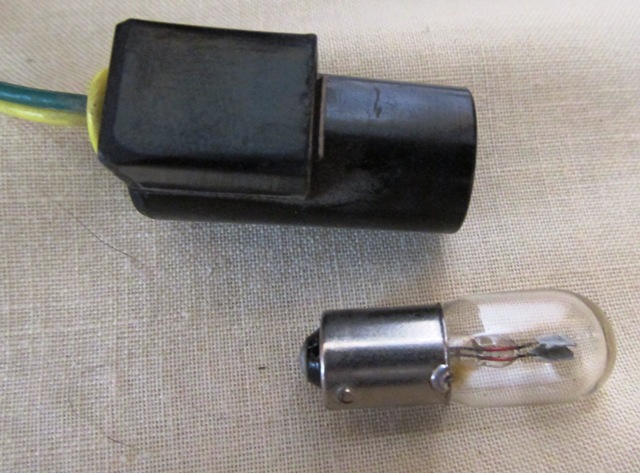

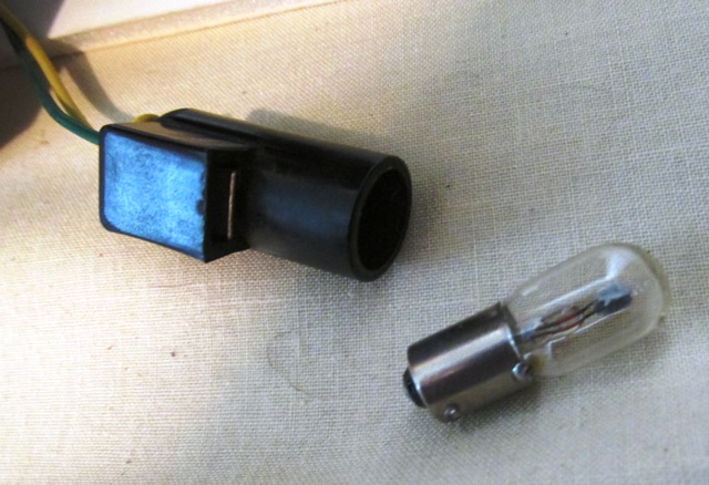

bulb pictures
21.Aug.13 04:46
121 from 4448
Michael Mirin (USA)
Articles: 7
Count of Thanks: 3
 Here are the pictures of the bulb. There is no marking on the bulb.
Panasonic 782
21.Aug.13 06:31
131 from 4448
Articles: 2327
Count of Thanks: 17
Yes, it is a neon lamp.
Measure the voltage before and after the R34 / 100kΩ.
I think the resistor is defective and not the neon lamp.
Regards WB.
