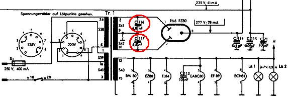

Poor insulation of the capacitor
28.Nov.10 04:58
32 from 3815
Articles: 2327
Count of Thanks: 17
Look at the filter capacitors.
These can unsolder for the experiment.
I am sure that the insulation of the capacitor is bad.
Regards WB.

Emilio Ciardiello
Looking at the diagram, I fully agree with the diagnosis of Wolfgang. Unfortunately smoke is harmful for transformers as well as for humans. If smoke came out from the transformer, some paper layers are now carbonized and lost their insulating properties. So, even if the radio works again after replacing capacitors, the tranformer is unsafe and should be replaced or winded again.

Bob Isaac
Thank you so much Emilio and Wolfgang,
  The problem was indeed the two capacitors suggested by Wolfgang.  I replaced them with two new 6800 pF capacitors and checked the temperature of the transformer off and on over a 15 minute period of playing the radio.  There was no significant warmth to the touch, so perhaps I caught the initial problem before irreparable damage occurred.  Thank you both again for your thoughtful and knowledgeable advice.
