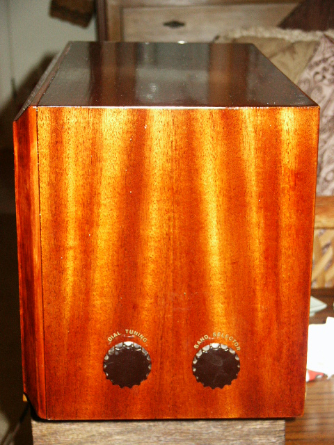

Picture Update
28.Sep.09 03:02
Chad Comstock (USA)
Articles: 7
Count of Thanks: 19
My card reader isn't working, so I've been able to put on a few more coats from this morning. I plan on sanding this coat down and finish with one more for a total of 6.

Finished with the finish.
30.Sep.09 04:21
Chad Comstock (USA)
Articles: 7
Count of Thanks: 19
I've done all I can do, coat, sand, coat, sand, coat................done. The dial and fabric could use a little work but I'm not sure what to try, I vacuumed the fabric, cleaned the dial as much as I could. It looks wonderful compared to what it did.
