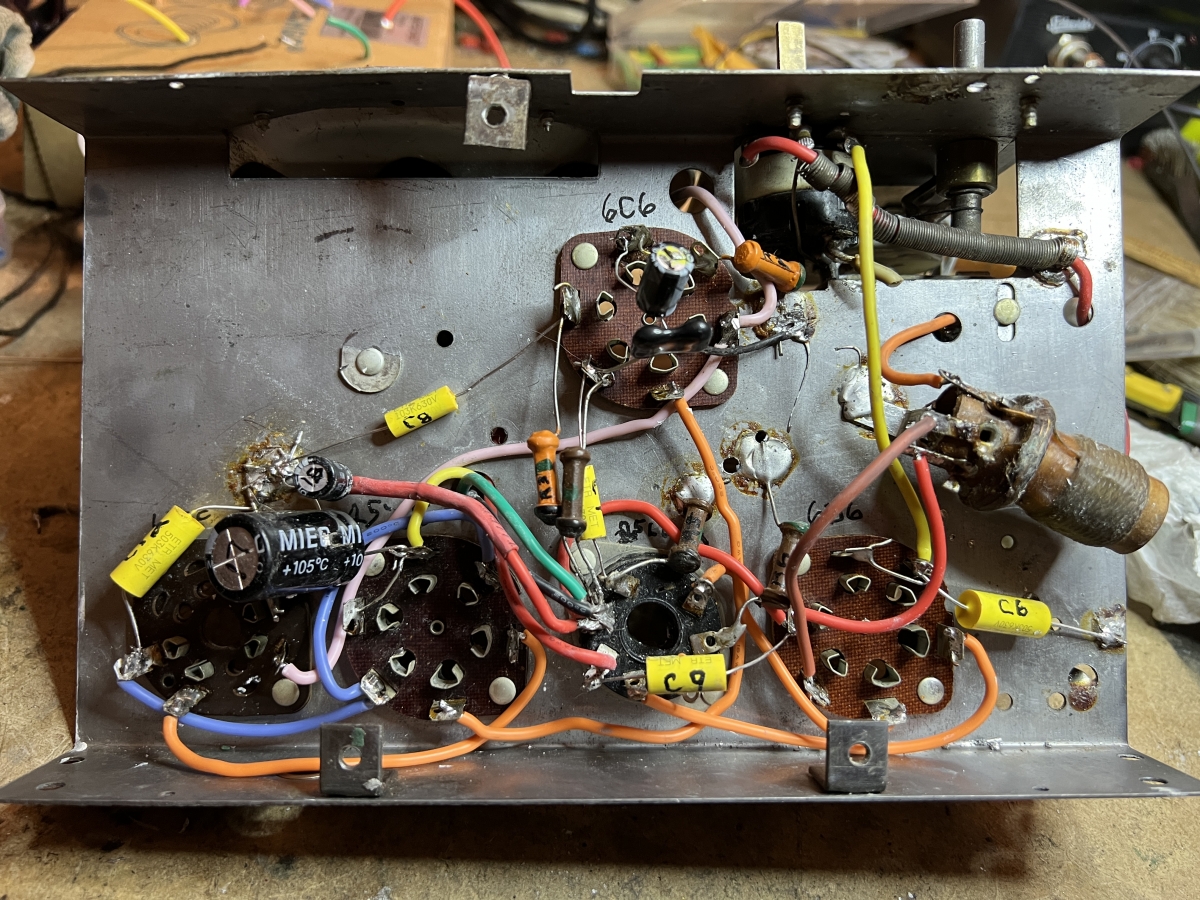

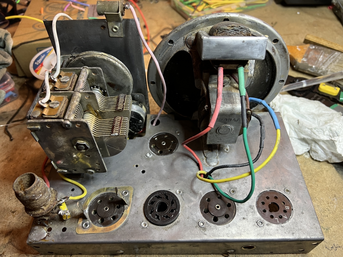

I wanted to share my restoration project with you. It's a radio that I got from a seller on Facebook Marketplace for $25. Initially, it was in terrible condition, with the cabinet damaged in several places and the veneer coming off. Additionally, the chassis was in terrible shape, covered in dust and mouse droppings. One of the tubes had a loose metal casing that came off, exposing the innards. It took me a while to clean everything up, and in hindsight, I probably should have worn a mask.
Since I intended to keep this radio for myself, some of my restoration practices may not count as true restoration, but I'm happy with the results. I removed all the tubes and the condenser and cleaned up the chassis with a wire brush and metal polish. I then sprayed the top and bottom sides, the condenser, coils, and the pot with contact cleaner. Next, I replaced all the old cloth-covered wire with new silicone-covered wire, which is more durable and easier to work with. I also followed John Fuhring's instructions for making a hot chassis cold. All the resistors were in spec, so I left those alone. However, all but one of the vacuum tubes failed, so I ordered new tubes.

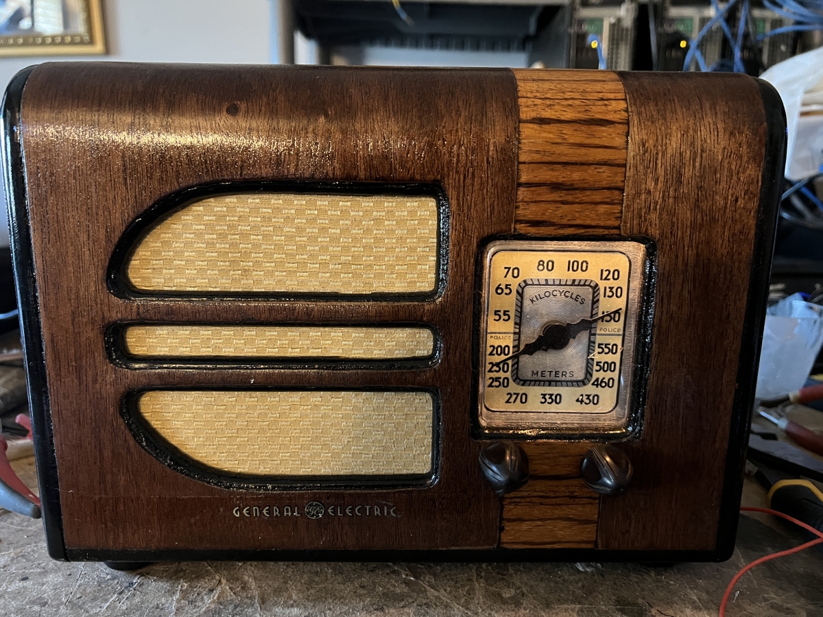

While waiting for the tubes to arrive, I started working on the cabinet. I had to determine what wood was used for the veneer, and I settled on mahogany. I ordered a self-adhesive sheet from Amazon and removed the old veneer, being careful not to damage the lighter wood veneer, which was not damaged. I filled in all the chunks removed from the underlayment with wood filler, so the veneer would have good purchase. Furthermore, I painted all the black bits with Rustoleum black lacquer spray paint. When the new veneer arrived, I was surprised at how easy it was to apply. I didn't cut out the speaker, dial, and knob holes before attaching the veneer, but I had plenty of veneer to start over if needed. I used an X-acto knife and got them from behind and then shaped them. I stained it and sprayed everything with clear coat. I replaced the grill cloth and the dial glass, opting for a plastic replica. The new GE decal arrived yesterday.
With the cabinet done, I installed the new tubes when they arrived. To my surprise and pleasure, the radio worked and seemed to be aligned! However, the volume pot is a bit sketchy, and I couldn't fix it by cleaning it. I'll look for a replacement. If you know where I can find a new one, please let me know.
Overall, I'm quite proud of this restoration project, both electrically and in terms of the cabinet. I hope you like it too.
