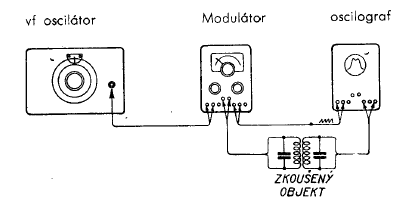

Dear Mr. Flueck,
according to czech description this device is used to get rf frequency depending signal for tuning of rf circuits, bandpass filters and similar devices by using external generator and oscilloscope. BM240 contains hf oscillator and mixer. I have attached example of possible usage.
Gabriel

Thank you, Gabriel, now it´s getting much clearer what I can use the device for. I will try it out soon. Best regards, Tobias Flück
