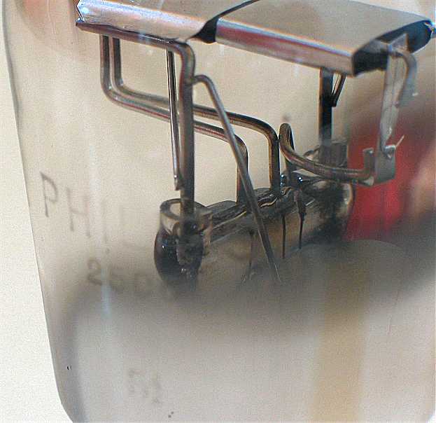

Can anybody contribute an authentic datasheet with base diagram of this valve, or a picture, where the indirectly heated cathode tube is visible ? Any of the schematic diagrams of the Philips 2514 receiver shows up only the direct heated 506.
It will help us much better if we have clear evidence rather then rely only on rumors or saga.

Jacob,
The Philips 2506 is well documented into tube literature. See e.g. 70 yrs of Radio Tubes and Valves (Stokes) page 117. Or the advertisement in Wireless World, December 4, 1929, adv.p. 6.
See attachment for the 2506 pics. Attachments:

Many thanks, John, for these pictures,
to me and likely to many others as well, a longtime hidden mystery has been uncovered !
Would you please put all these pics to the tube page itself ? Thanks in advance !
Now we only need an authentic datasheet too, then this chapter will be completed.
