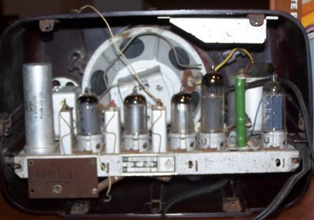

I have a new radio Siera. Without model or any identification.
Can someone help me?
Thanks in advanced,
Luís Santiago

Hello Martin,
what can I find in the typeplate is this:
SA1000270
The tubes are type"U" and I identified one as "UY42".
I don't know if it is enough to find the Model.
Best regards,
Luís

Hello Martin,
this weekend I tried to find more identification about the Siera Radio. In the back side of the typeplate I could find more information about the device. For that I used a magnifying glass and I was able to find this:
Type: SA1000U70
220V    45W
The tubes are: UY42; UF41; UL41; UBC41 and another one without any kind of identification.
In the same typeplate I found a symbol of Siera with "Made in Holland"
Best regards,
Luis

Hello Luis.
You will find your radio in the Radio Museum database www.radiomuseum.org/r/siera_sa1000u70sa_1000_u7.html
edit: and I now noticed you added it, thank you.
Frank

The dial and chassis look similar to a Philips set I have. Could it be made by Philips under license?
After a quick look, here is a photo of my Philips BX135U chassis. Very similar.
