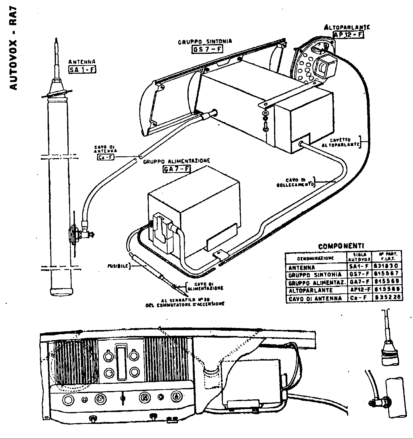

Hello,
the module in the picture should be the tuning unit of the RA7 car radio, for which the schematic diagram is already available. Please check with the following mounting drawing referring to the installation on an old Fiat 1400.
