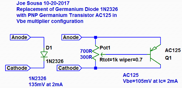

If I had to replace a 1N2326, I would use a PNP germanium low power audio transistor like an AC125 in a Vbe multiplier configuration as shown in the following diagram.
The schematic is only a suggestion derived from data sheet values and has not been verified with simulation or measurement. During all experimentation you should have the speaker disconnected until the output DC voltage has been adjusted to zero volts. Mounting the AC125 on the heat sink with the power transistors takes the most advantage of thermal stabilization.
The AC125 are cheap and common in auction web sites. I mention this particular type only because the AC125 data sheet on Radiomuseum.org is extensive enough to specify the forward Vbe drop. It is very likely that a comparable low power audio germanium transistor will have a low enough forward Vbe drop to work. The advantage of the Ge transistor is that the total voltage drop can be adjusted precisely with the trim pot circuit to get the amp perfectly biased.
The forward drops are specified in the data sheets as:
1N2326   135mV at 2mA
AC125    105mV at 2mA
In theory, the 25mV lower forward drop of the AC125 wired as a diode with base tied directly to the collector as the cathode and emitter as the anode, will run the output Germanium transistors at a little less than half the desired current, unless the Vbe multipler trim pot is added to increase the forward drop slightly as shown in the diagram.
