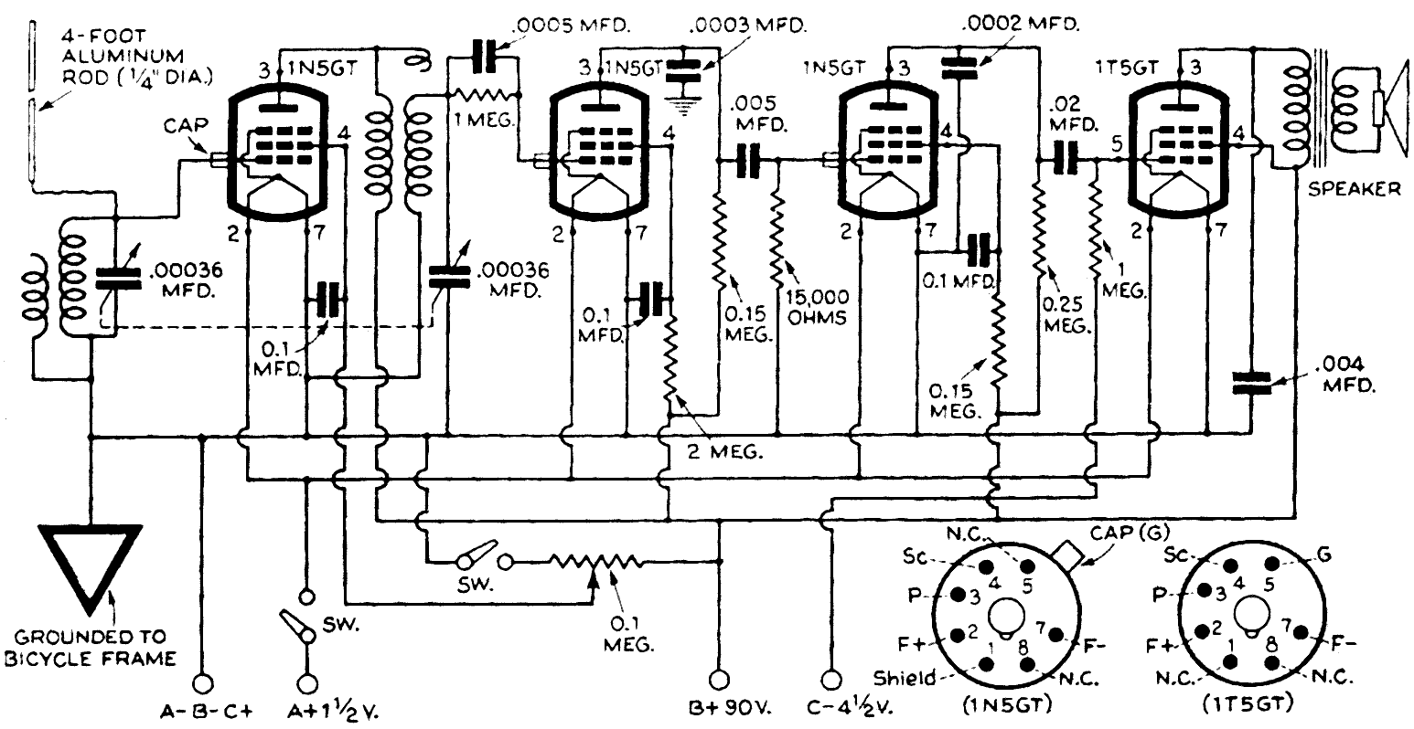

Owing to the directional properties of a loop antenna, a 4' metal rod was chosen instead. The metal rod is connected directly to the grid cap of the radio-frequency tube. Both of the set's coils are tuned by a midget two-gang tuning condenser, which is mounted on the sloping panel by means of two right-angle brackets.
The antenna rod is insulated from the metal cabinet by a ceramic stand-off insulator. The tops of these insulators are usually threaded, and the best method of attaching the aluminum rod is to thread it to fit, and screw it into the insulator. For greater signal strength, the set will have to be grounded. The bicycle frame provides excellent counterpoise capacity for this purpose.

In order to obtain ample volume from the speaker, two stages of audio-frequency amplification are used after the detector. Both stages are resistance-coupled and use the latest-type tubes for maximum sensitivity. Type 1N5GT tubes are used in the radio-frequency, detector, and first audio-frequency stages. A beam power tube, 1T5GT, is used in the output stage, and provides a relatively high output with a very low filament drain.
A 15,000-ohm, ½-watt resistor is used in the grid circuit for the first audio tube. Any increase in value of this resistor will only cause instability and will fail to increase the amplification. Volume is controlled by a 100,000-ohm potentiometer placed in the screen circuit of the radio-frequency tube.
The key-lock switch is of the double-pole, single-throw type and breaks two circuits at one time, the positive "A" supply and the ground lead of the volume control. This is done to avoid any drain through the "B" supply while the set is turned off.

Circuit diagram is attached.
