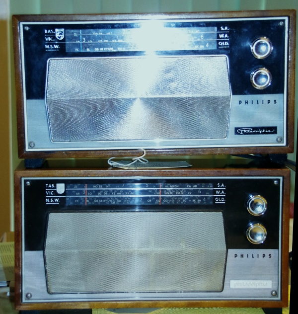

There is confusion between the MM2 and the MM2.01. The MM2.01 uses BF series transistors in the first  (RF) module whilst the MM2 uses the earlier AF series. The schematic listed for the MM2.01 is for the earlier MM2.
The two models can be distinguished by the type face used for the word Philadelphia (white on silver for the MM2.01)
The RS300, which is the MM2.01 in a wider case with an alarm clock uses the later transistors.

Thank you Brian.
The schematic for the MM2 is moved to the page of the MM2 now.
