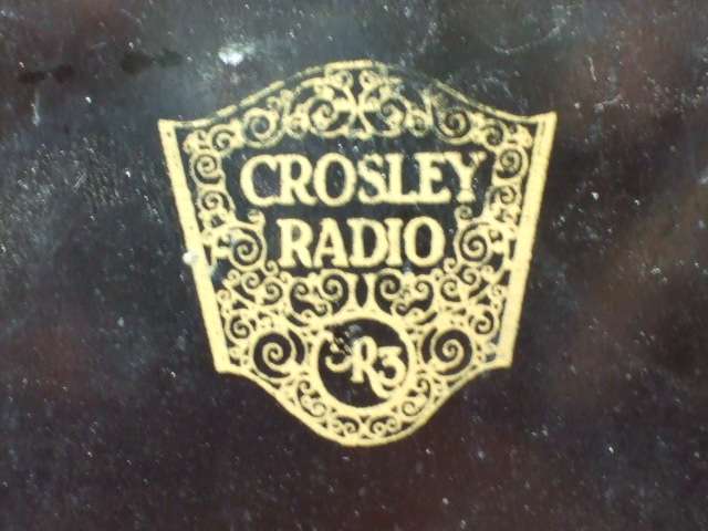

Hello,
    I have just bought from an eBay auction a radio which seems to be a R 3 from De Forest - Crosley. There was not  case, only the chassis. It is in fair condition, all components inside, transformers OK... I have drawn the schematic, is a reflex with regeneration like Trirdyne, or 3R3 from Crosley. The sockets are mounted on a hard rubber board which is marked  "R 3  1906"  .  Last number seems to be a year but it could not, at 1906 there are not this kind of receivers.. I am enclosing some photos.
    Regards.
    Félix. Attachments:

DeForest-Crosley R-Series were introduced in 1925. The Chassis of Your radio looks similar to the (US) Crosley Trirdyn 3R3 here. Only the front panel elements are rearranged. There is only a single filament rheostat, and the reaction control moved to the place of the former 2nd rheostat..
In particular Crosley did such rearrangements to create "new" models, which really inside used the existing chassis structure. Rationalization was it.
