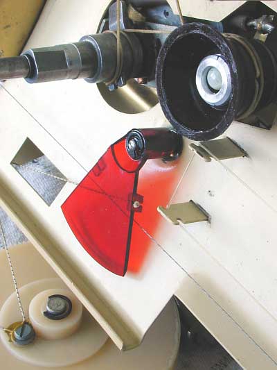

Below I have attached a photo of the front of the indicator, the lightbulb is just visible within as the milky white glass sphere in the middle of the blackish plastic drum, upper right. I have tried applying sufficient force in different placed that I have nearly started to bend the whole thing, yet nothing has given way even for a fraction of an inch. So before I start trying to force it even more, using heat or chemicals, in the hope that it is just corrosion, I'd like to know what the proper procedure for removing the lightbulb is in the first place!
There is also a flat, wide spring at the back of the assembly (not visible here), which looks like it might be intended to be pushed sideways, thus allowing the bulb to be removed through the back of the socket. But that spring haven't budged even a little bit either, despite my efforts to move it.
The photo also shows the left tonal control and the indicator wing, and one can clearly see that in this position, the red dot to the left, there is still plenty of room for the wing to move even further to the right if the string was a bit longer. But, as can be seen, the factory seal on the string is still in place, so I am a bit mystified here as well.

Found it. The lightbulb goes out the back as I suspected. On my radio the bulb has apparently not been replaced since the radio was manufactured, so no-one had noticed that a larger-than-needed blob of solder blocked the sideways motion of the retaining spring on the back of the lamp holder.
After I first lifted the spring a bit to clear the rear of the bulb, I was able to gently move the spring sideways and above the blob of solder. This also makes a lot of sense, as one can then replace the bulb without completely dismantling the radio.
The bulb has a BA7s bajonet base, is kept in place by a little coil spring and has a short, cylindrical glass envelope. The front half of the glass is painted a pale, milky white, probably to cut down on the light output.
