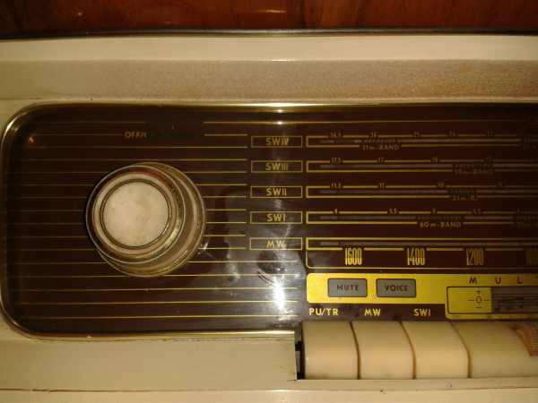

Hello Mark:
I received today a clear picture of the dial scale. I can see the radio does not have FM.
I am enclosing the picture.
The mistery continues, How can I find this model on the RMorg list?
Thank you very much for your soon answer and kind regards,
José

Dear José,
you can't - you'd have to create the model entry first. I am fairly certain that this is a 7038 - however there remains some doubt, which will have to explained in the notes of the model.
Kind regards
Mark
