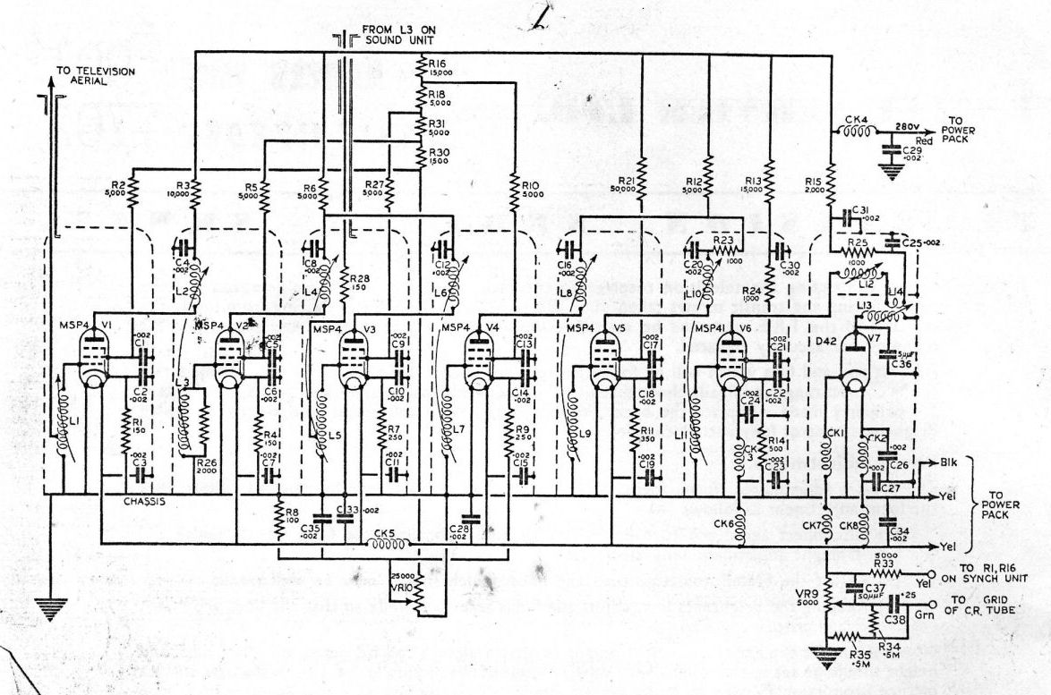

At this time there was only one television channel and one transmitting station. This set is designed with a straight (TRF) vision receiver tuned to 45 MHz. and consists of six RF pentodes and a diode detector. These are contained in the screening cans on the left. There is no video amplifier. The detector connects directly to the CRT. To the right of the CRT are the synch separator and line and frame timebases and on the floor of the cabinet is the power supply chassis. The 5000 volt supply for the CRT final anode is generated from a step up transformer from the mains and this and the EHT rectifier are located below the timebase chassis in a metal box behind the two brightly lit HT rectifiers. Only a small part of the sound receiver is visible in this picture. It is a superhetrodyne receiver tuned to 41.5MHz and shares the first two RF stages with the vision receiver and its RF connection can be seen between the second and third cans from the top.
TRF Section
TRF Section
