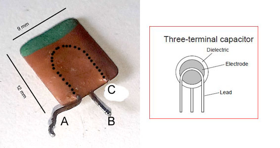

Dear Forum members,
I just uploaded a hand drawn circuit diagram for this model.
There is one component that bothers me:
it is C1: I unsoldered it, and it doesn't seem te be a capacitor.
It has a green stripe on top, and one wire has been cut.
It measures 9 x 12 mm.
When I measure the C-value, it gives about 12 nF, but when I measure the resistance it gives 3400 Ohms. I suppose it is a R-C combination.
Can anyone tell me more about it, please?
Thank you!

Dear Mr. Campenhout,
sorry I can't open the schematic on this computer, so I can't verify if my guess makes sense. But that looks either like a voltage dependent resistor or more likely a NTC / PTC. VDR have definitely a large parasitic capacitance, for thermistors I don't know. But they're ceramic, so maybe...if it's not the resistance irritating your meter.

Dear mr. Thies,
thank you for your answer.
The reason why I unsoldered the component is following:
As I mentioned in my first post, I tried to draw the circuit diagram of the EK80. I was unable to read the value of a number of components because they are very densely mounted on the pcb.(they do not have a value written on my diagram), amongst them C1.
If you look carefully at the picture of the component, you'll see that there are 3 connecting wires, one of them has been cut. This was so in the circuit, I did not cut it.  The two extreme wires A and bB are at one side, and the middle one C at the other side.
I measure (using a Voltcraft LCR meter LCR-9063) between A and B ca. 3400 Ohm/ 12nF, and between B and C equally 3400 Ohm/ 12 nF.
Between A and C: nothing!
I am almost sure that the capacity measurements are faulty, since the instrument indicates a value only at the range 200 nF. Nothing at the other ranges!
Strange!
Any thoughts are welcome.

Hello Mr. Campenhout,
it could be a double ceramic capacitor, but only half of it was used. If so, it is defective because of the measurable resistance of 3400 ohms. The connection between A and C should be low-resistance. However, you write that this connection does not exist. Can you check that again?

Good afternoon mr. Cucuzzella,
Super!
This is indeed the correct answer: it is a double ceramic capacitor, where point A and C are the same conductor.
I join a picture where I added in a dotted line the conductor, an I included a schematic drawing of such a component(source: Murata leaflet)
It is clear that my item is defective.
I guess that its value should be 50 nF, referring to the green strip on top.
Thanks again and best regards.

Good evening dear forum members,
I have to come back to the subject.
The component is not a singe capacitor. I replaced the supposed defective one with a ceramic capacitor of 50 nF: no result.
Then I tested the set with a 3k3 Ohm resistor in parallel with a 50 nF capacitor, and the radio plays well.
This was easily possible, since the pcb has provision ( 2 times 2 holes ) for the two components.
This is good visible in the detail picture.
Last test: I mounted the original component again, and the radio is OK.
Conclusion: the component is a parallel mounting of a 3400 Ohms resistor with a 12 nF ceramic capacitor.
you proved nicely that the resistance is part of the circuit. However I can't believe that such a cheap set uses a special component when a standard R plus a C do the job. Did you check if resistance changes when warming the part with your fingers? I strongly suspect this is a temperature stabilization for the oscillator.

Dear Mr Thies
Upon your suggestion,  I unsoldered the component and measured the resistance under following conditions:
  • cooling down till freezing with Kälte Spray: very small change
  • warmed up with fingers: no change
  • room temperature: no change
I think we can assume that it is not a thermistor.
