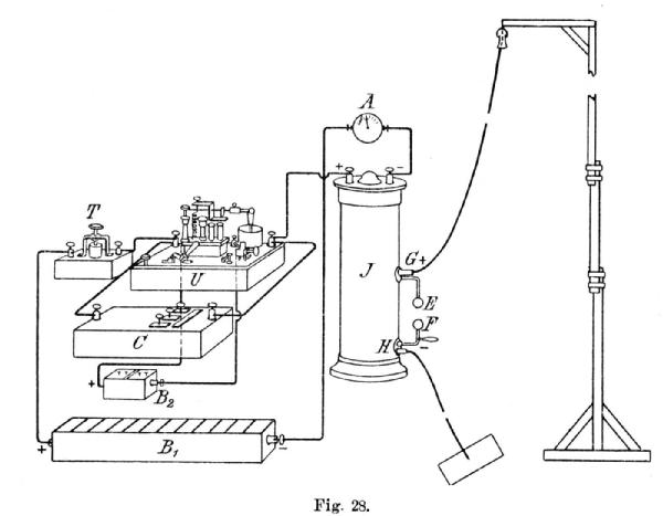

In the Elektrotechnische Zeitschrift (ETZ), No. 45 from Nov. 1904, there is a report on the French system of wireless telegraphhy by Rochefort. The transmitter instantly reminded me of this set.
This is a commercial type of equipment. It's an untuned Marconi transmitter. There is a separate mercury interruptor U, kept in constant operation by battery B2. The optimum number of interruptions is said to 24 to 30 per second. The key T with platinum tip and mercury contact closes the circuit from battery B1 (24V 100Ah) through the interruptor with condenser C in parallel, to induction coil J. The spark gap terminals are 2cm in diameter. A spark of 5 to 10mm length is employed.
