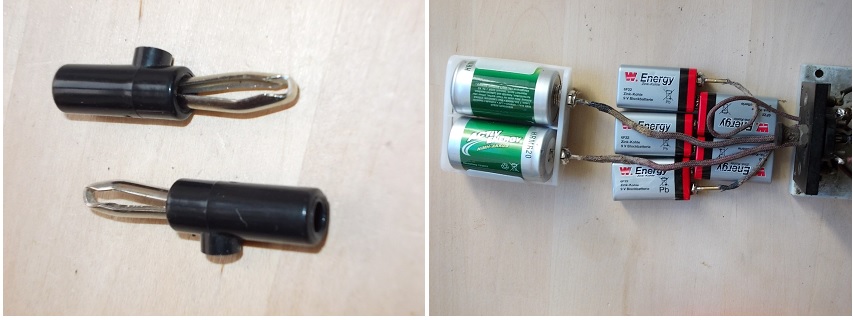

 The power supply connections were cut and in disorder. I sorted them out and soldered appropriate connectors to accommodate modern batteries:

       The sockets for connecting antenna, earth and loudspeakers are 3/16 inches (4.7625 mm) in diameter and not 4 mm. I had to look for cheep banana plugs which could be bent to (approximately) match the sockets:
       Then I connected the batteries: 2 X 1.2 VDC D size accumulators and 5 X 9 VDC batteries. I always start carefully, with a lower anode voltage.
