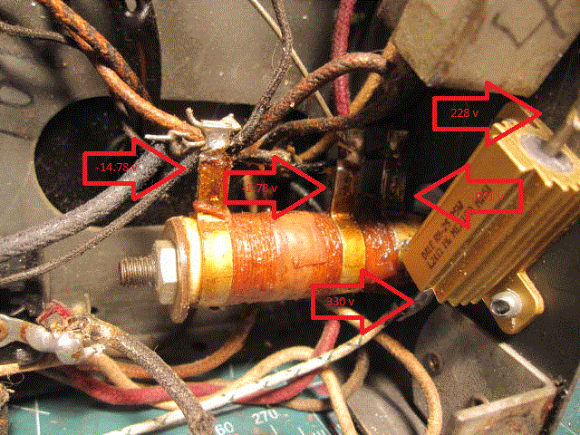

Here are some pictures of the radio with tags. I'm thinking maybe I'm taking the readings in the wrong place.
Waiting for a new 42
01.May.13 21:38
283 from 5400
Emilio Ciardiello (I)
Articles: 527
Count of Thanks: 22
Emilio Ciardiello
Hi Bill,
I am sure that you are taking the readings in the right places. Unfortunately there can many causes of drift. The voltage depends upon the current flowing through the tubes, about 80% through the power amplifier. But the current might be limited by a poor cathode emission in the power amplifier itself or in the rectifier. Consider that certainly you have an oveload condition even in the power transformer, hence a resistance increase of the windings. In these conditions you could observe a drop in the heater supply and a consequent further decrease of the emission. Another probable reason of drift can be the progressive ionization of the gas inside the 42 as consequence of temperature increase. It is hard to follow the behavior of the whole circuit in these overload conditions.
Just as an experiment, waiting for a good 42, you can connect a smoothing capacitor, say 0.1 microfarad, 50 volts or more, across the voltage divider 47. You should observe a relevant increase of the negative bias, at least across the divider itself.
Emilio
