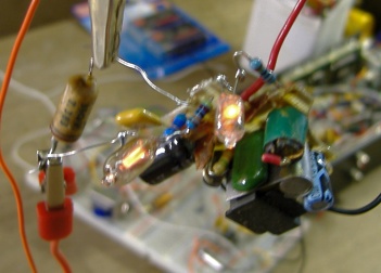

Misleading Test gear
01.Oct.11 01:24
9292 de 163522
Michael Watterson (IRL)
Articles: 1120
Count of Thanks: 68
Recently after a long gap I got an old 1950s radio to repair (or Restore?).
The most costly fault causing capacitor, between grid of DL96 and anode of DAF96 had already been replaced with what looked like a 1970s part.
But there was still four other Waxed paper capacitors of the kind believed to be faulty always in UK. The radio performance was erratic and poor.
I have one meter that tests up to 47M Ohms and is quite good. Also a Bridge and three electronic capacitor meters. The first wax capcitor I took out measured a little high on capacitance but measurable resistance at all. Just like an open circuit exceeding 47M.
But my Greyshaw Instruments CR50 bridge has a "real" leakage tester. It uses about 160V via several Megaohoms to one terminal and other terminal to a neon with low leakage capacitor. About 100M Ohms is 1 Hz flashing of "magic eye". With 10M ohms it flashes quite fast.
Testing the four remaining waxy capacitors all were OK on the DMM (> 47M), but on the 160V leakage tester the eye flashed very rapidly similar to a 2M  resistor!  With the replaced capcitors the radio was superb and HT current just under 6.5mA at 104V from the built in mains adaptor. (The Electrolytics all tested fine in circuit).
I think the fact is that in low voltage positions the Waxed paper (Waxys) may be OK, but with age they all 100% break down with higher voltage across them
So what do you do if you don't have a high voltage leakage tester? The Waxed Paper capacitors only "breaking down" at HT voltages not the 3V of modern meters.
All you need is an old camera with flash or a flash gun you don't want any more!
This will test at nearly 300V
1) Remove flash unit electronics from unwanted camera or gun
2) Remove flash tube and large capacitor (often 300uF 350V).
3) Fit a 400V 2.2uF or 4.7uF capacitor instead. Ensure polarity correct.
4) disconnect series resistor from neon.
5) Add 1M Ohm to end of existing resistor you disconnected from neon. Connect to a test Terminal "A"
6) put a low leakage 100V or more rated 100nF ceramic or foil (not electrolytic) across the neon and connect the end that used to have resistor to test Terminal "B".
7) Put in a little box with suitable battery and on/off switch. Cut off the trigger wires.
Testing
a) If you short the terminals the neon will flicker very fast.
b) If you put a 1uF capacitor the neon will light then flicker more and more slowly as it charges up till neon goes out. Now the test capacitor is charged to over 250V.
WARNING
While you can't get a shock from the tester or a faulty capacitor a larger value good capacitor may have a dangerous amount of charge and should be carefully discharged.
My "new" capacitors all pass on the box (neon goes out). Even ones rated only 100V!  All the Waxed paper capacitors failed totally, neon on virtually solidly!
Conclusion
The above article is excellent in depth, but most non-specialist test gear doesn't have enough voltage to test capacitors for valve (tube) applications.
Early test of flash gun circuit
Innards of Flash gun
Completed box (lid is arranged as bottom)
Inside Leakage tester
You can see lit neon at bottom and the new 400V or 450V 2.2uF or 4.7uF capcitor
(The original capacitor takes too long to charge)
Cut up Margarine tub as insulation under the flash gun circuit.
A Waxed paper cap failing
Completed leakage tester

Dear Michael,
I tried to explain that virtually all the capacitors have some leaks. I am quite conservative and in my opinion original components must be retained while the set, where they were mounted by the manufacturer, is still working fine. What is important in the restoration of an old electronic set is to understand when a component really must be replaced. The effect of the leakage on the circuit, rather than the measurement of the absolute leakage itself, is to be evaluated to take a decision. The insulation meter can help to understand what happened, after the problem was fixed, or even to prevent a probable future failure. Anyway, if I decide to measure the many thousands of capacitors I have in all my working sets and replace all the leaky ones, I should either book the entire one year production of a large manufacturer or, better, open a new plant to produce my own replacement capacitors. Yet all my sets work fine and just in the latest two months I restored four Tek tube oscilloscope, replacing only four capacitors, two were dried, out of some thousands.
I do not agree on the possibility of obtaining really useful information by a flashing neon. Anyway simple measurements can be run with ordinary instrumentation. For many paper capacitors the evaluation of their in-circuit behavior usually gives sufficient information to decide if any replacement is required. The job can be done with a simple multimeter and the result is even more reliable of any measurement made on the capacitor after having removed it from its circuit. The figure below shows the three basic DC circuits where a paper capacitor can be found.

Your Fig1 is very clear.
However a Battery valve set would want to be powered with the filament battery disconnected as the 90V HT is needed to "show up" the capacitor breakdown. If the heater was connected the audio output transformer might be damaged before the voltage can be meausred.
Also in some situations the capacitor might not be easily accessible to the multimeter when the set is powered normally.
I too believe there is no need to automatically replace every component of  a certain kind. I do only replace parts only actually faulty.
I think though with non-electrolytic capacitors we must differentiate between leakage and actual breakdown. On my set none of the replaced capacitor had measurable leakage (all > 47 M Ohm) without HT, but all  about 2M ohm with approximately 50V DC. At 300V DC, the 350V capacitors behaving like < 1M Ohms.
My cheap "tool" sugguestion is for those situations where it's not safe or easy to test the voltage drop across the capacitor with a Multimeter (Which often has an upper limit of 10M or 47M for measuring resistance, which may suggest the capacitor is fine when it isn't). Note also that many cheap DMMs are only 1M Ohm and the better 10M Ohm meters on voltage rage while suitable in many situations may not be high enough impedance for some circuits to decide if there is a problem with capacitor or you are seeing current through the DMM (470k Grid resistor vs 4.7M Grid resistor).  If in doubt test the capacitor at the working voltage, not the low voltage of cheap meter.
Expert examination of a circuit (if available) will suggest what is acceptable leakage. But none of my "stock" non-electrolytic capacitors (even ones only rated 50V) light the neon at all once the capacitor is charged.
Just an arbitrary value
