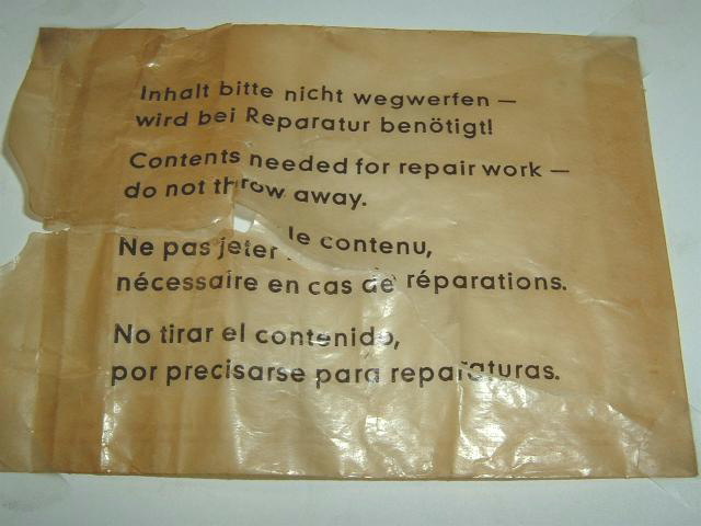

Dear Radio lovers,
When repairing my set, I found a little brownish paper bag inside, which contained two 60mm long transparent plastic tubes, diam 4 mm, with inside a black 15 mm long part (ferroxdure?), as well as a spare glass fuse.
What are these for?
Spare parts for the IF Filters
30.Jan.05 19:28
Articles: 2120
Count of Thanks: 8
Hello Mr. Campenhout,
these two pieces are Coil -cores for the AM IF (460 Hkz).
In this years Siemens use a splendid or grazy form of Coil Cores.
They have not a thread, only two cylinders coaxial.
The Cores are moved, to alignment the IF Filters,  by shifting one in other.
When finish, those two coaxial Cylinders was fixed with a fusion by heat.
(soldering iron)
If you need or use later on of those Cores, you can find it in that Paper inside of the set.
I think thats clear.
Regards Hans M. Knoll
