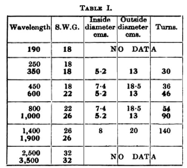

My transformers have basket coils as primaries, and as a rough guide, I give particulars of them in Table 1. Lattice and other coils will no doubt, be just as good.
