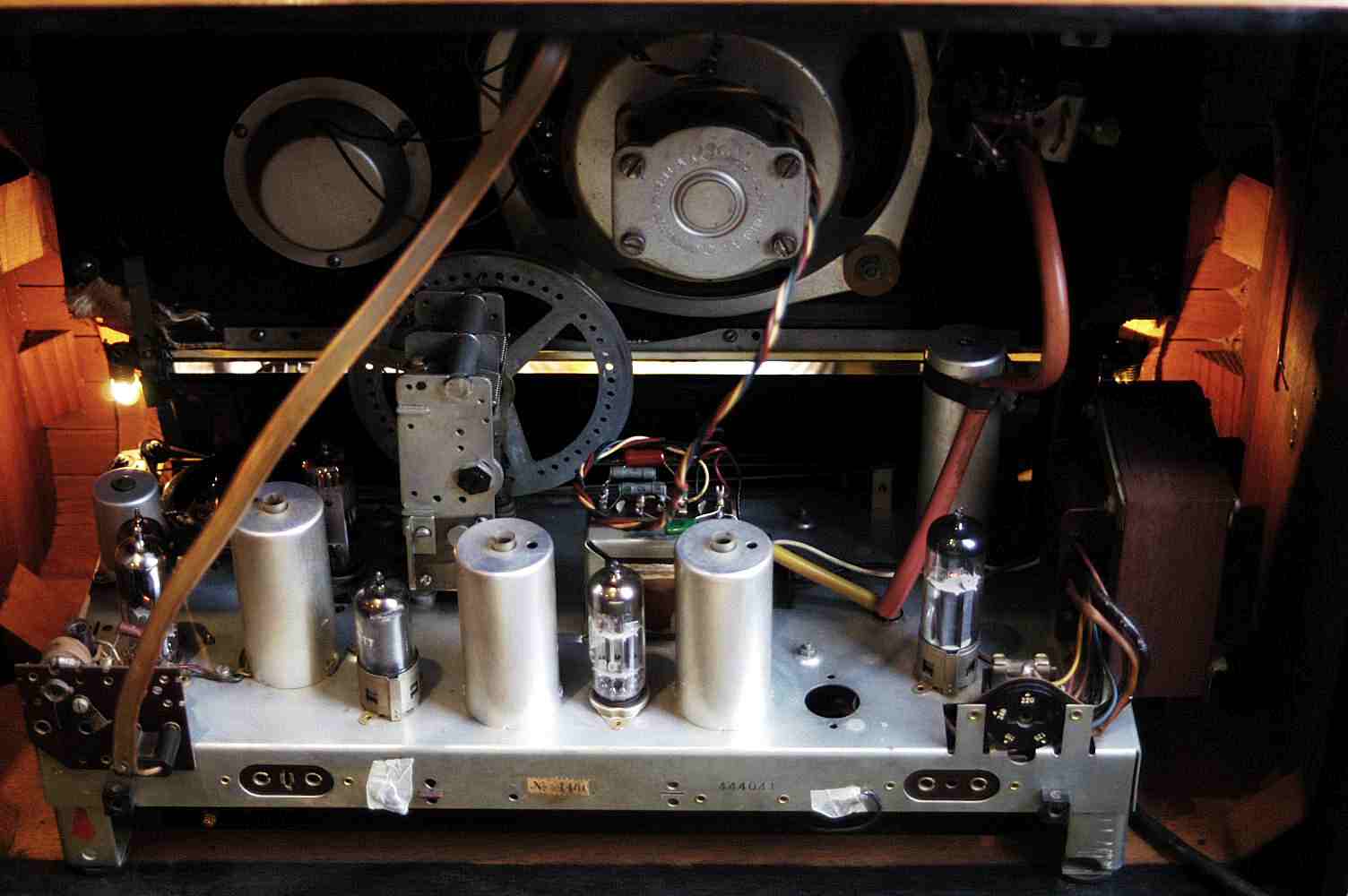

My intention is not to argue with the respectable administrative gentlemen but the Allegro model is a six tubes radio in the R Museum page.  The Allegro S model is a seven tube radio with two tubes (EF85 - EC92) in the UKW unit.  The Allegro have only one UKW tube (EF85) according RMo.
In the attached files you will be able to see the Original seven tubes Schematics in the ruckwand of my restored Allegro S.  Then I think that I uploaded the correct schematics.

With the antecedents available it is possible to theorize that Allegro S is a improved model only in the cabinet for the 50 anniversary of Telefunken in 1953. The schematics is the same one in both models.
The model Aleggro S has patch in ruckwand the Allegro schematics , then seems logical to upload the Allegro schematics to the Allegro S page.
