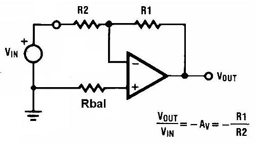

Typical open-loop gain of a 741 op-amp is greater than 50V/mV: then a signal difference of fractions of millivolts in input would drive the output stage to saturation. We need to introduce a negative feedback, as in the circuits below, with signal to the non inverting or to the inverting input:
Fig. 2 - At the left the typical diagram of non-inverting amplifier, at the right an inverting amplifier. In the first circuit the signal Vin sees near to infinite impedance. In the second circuit the input impedance is R2, since the node between R1 and R2 is a virtual ground.
In the first circuit, the signal is applied to the non-inverting input and the inverting input moves to the fraction of the output signal present on the divider R1 / R2. In the second circuit, the Vin signal is applied to the inverting input and adds algebraically to the feedback voltage, so as to always drive this input to the potential present on the non-inverting input. In other words, the node between R2 and R1 constitutes a virtual ground, which can be used to add several signals together, as in the circuit in fig. 3. Note that currents, the ones coming from external signal on the left and the one coming from the output voltage through the feedback resistor, sum algebraically in the In- node, so to force its voltage to the same value of In+, in this case ground. All the currents flow according to the arrows, none flowing in the inverting input pin. Actually in bipolar op-amps small currents flow in the two input pins. We are neglecting them since in this case, due to high gain of the amplifier, they are much lower than the ones indicated by the arrows. These currents, in the order of a few tens or hundreds of nanoampere, are defined input bias currents or Ib.

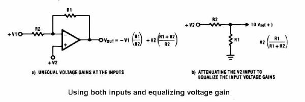

Left: Generalized summing amplifier. Inputs can be expanded and AC signals can be superimposed to some of them, when required. - Right: How to use both inputs to sum two signals. The same circuit, with voltage divider on the non-inverting input connected between Vs+ and Vs-, is normally used to set the quiescent DC output voltage of the op-amp.

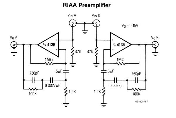

Some op-amps were intended for audio applications. They were designed for high slew rate and mainly for very low noise. Left: RIAA equalized preamplifier for phono pick-up cartridges. - Right: The same low-noise op-amp can be used for this stereo tone control.
