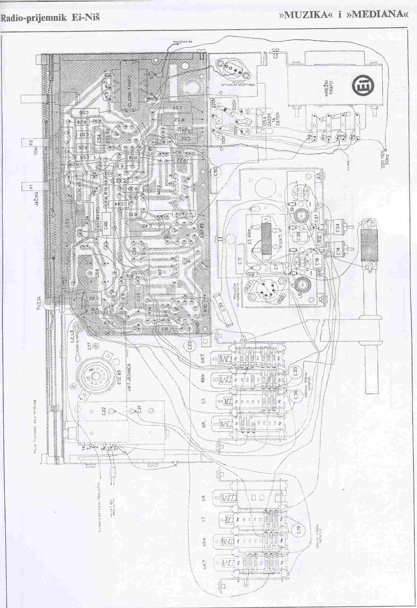

01.Aug.06 08:53
Berislav Bradaric (HR)
Beiträge: 48
Hello mr. Henning
I was accidentally find this schematics diagrams.
I'm guess that one of these two models match your model "Frankfurt III".
But I don't have this radio and can't state 100% sure which one.
There was two models with this chassis, "Muzika" and "Mediana".
I will upload these diagrams here in forum and someone who have this model need to check is it have differences or not, and which one match to "Frankfurt III".
Sorry for poor picture quality, but I get it like it is. I don't have originals to make a better quality scan.
Best regards.
03.Aug.06 12:32
Henning Oelkers (D)
Beiträge: 588
Henning Oelkers
Hi, Berislav,
i have made a short check. The Model "Muzika" is equal to "Frankfurt III", the PCB View fits,
and the Chassis Diagramm fits too.
I would recommend to upload the Information to the Model FrankfurtIII, directly on the Model Page.
Even if the Scan Quality is not the best, it is readable and valueable Information.
If You need any help, please ask, and we will be happy to assist.
Many Thanks!!
Best Regards,
Henning Oelkers
