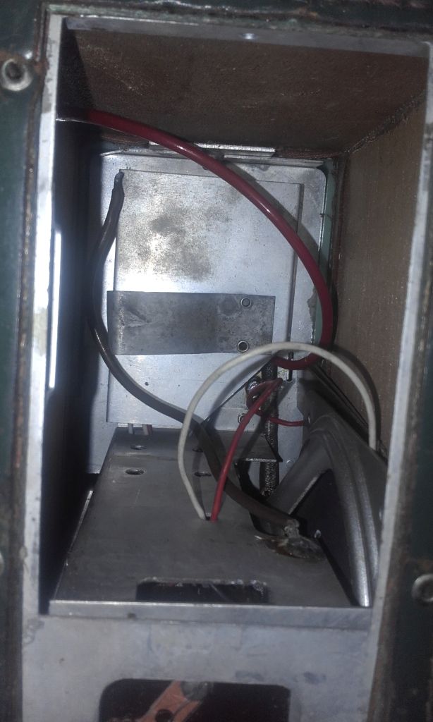

Hi Mark,
Additional Photos.  And some observations.
It uses a 7.5v battery and a 90 volt battery.
The AC supply uses 2 silicon diodes for each supply.
The case is leatherette covered wood like a cigar box wood.
The volume control is geared reduction drive
The screws are flat blade counter sunk with metric thread
Thanks very much for looking at this, I know you must be very busy.
Regards
jim

Hi Jim,
Thanks for the images. As I already thought, there's no indication of a manufacturer anywhere.
However we can make some observations:
  • it's a (small) series production
  • it might still be a kit radio - you'll be the judge of that: is the soldering done reasonably professionally everywhere?
  • the mains transformer might be for 25 Hz mains, entirely not uncommon at that time
  • the dial is fairly standard. Export models would usually omit MW in favour of an additional SW band. Also "usually" export models have 50 Hz mains (but it depends)
  • it has no RF preamp stage
  • the year of build is somewhere between 1956 and 1959. You might be able to determine it more precisely if you are able to locate date stamps on electrolytic caps or the speaker chassis.
That's about all that can be said right now. It might be worth asking on one of the french forums if somebody knows this radio.
What are your questions otherwise?
Cheers,
Mark
