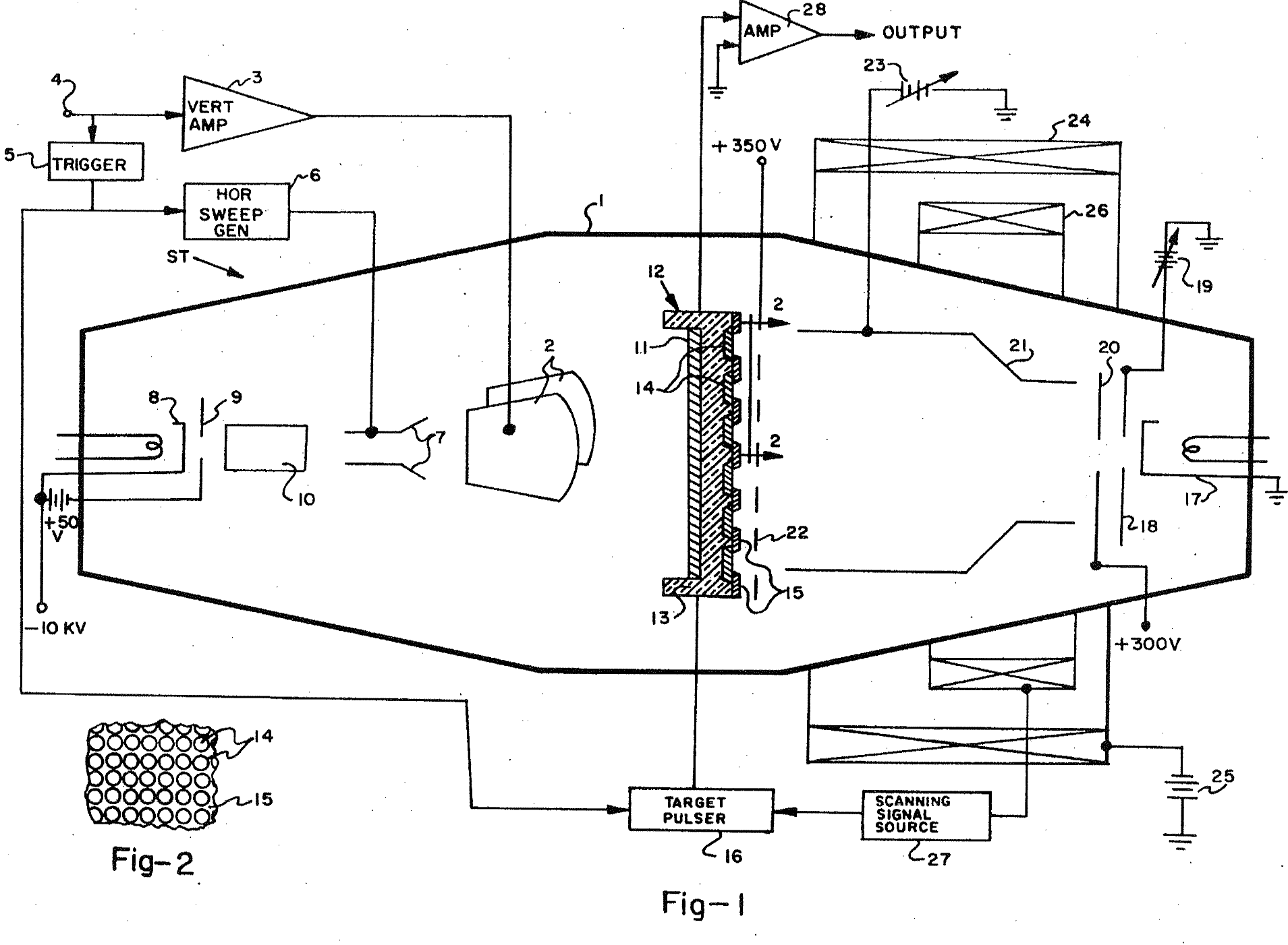

A scan converter storage tube ST illustrated in FIG. 1 is provided with an evacuated envelope 1 which is
preferably glass, but it can be made from any suitable dielectric material. The electrical signals to be dis­played are applied across a pair of vertical deflection plates 2 of an electron gun, at least one of which is con­nected to a vertical amplifier 3 which in turn receives input signals from input terminal 4. A trigger circuit 5 is connected to the input from terminal 4 and its output is connected to horizontal sweep generator 6 which is connected to at least one of horizontal deflection plates 7.
A cathode 8 is located at one end of the tube and it is connected to a minus 10 kv. voltage for generating a high velocity beam of electrons through a control grid 9, which is connected to a minus 50 volt supply, a focusing anode or lens structure 10. The horizontal sweep generator 6 applies a conventional sawtooth or ramp-shaped sweep signal across horizontal deflection plates 7 when trigger 5 is actuated by input signals applied to input terminal 4 thereby triggering horizontal sweep generator 6 and the input signals are also amplified by vertical amplifier 3 and then applied to vertical deflection plates 2 thereby causing the electron beam to be deflected along a writing area 11 of a diode array storage target 12, which is similar in construction to that disclosed in U.S. Pat. No. 3,440,476. Information may also be written onto writing area 11 of storage target 12 by optical means in accordance with conventional techniques. Writing area 11 constitutes a thin region of N-type material such as, for example, phosphorus-doped silicon to provide an N plus layer within an etched area of an N-type silicon wafer 13 which has P-type regions 14 formed within wafer 13 to form a planar array of P-N junction diodes thereby providing a plurality of discrete P-N junctions with respect to common substrate 13. An insulating coating 15 of silicon dioxide, silicon nitride, or the like, covers the reading area of target 12 and overlaps the exposed edges of the junctions.
A target pulser circuit 16 of conventional design is connected to target 12 to provide operating voltages in accordance with the voltage waveform VW of FIG. 3 thereto and it is connected to trigger circuit 5 to cause pulser 16 to operate in synchronism with the input signal. Voltage waveforms VWa of FIG. 4 and VWb of FIG. 6 are also produced by pulser 16.
The target pulser 16 contains an electronic switching circuit which connects the target lead to various volt­age levels. The switches are controlled by gates which are connected to timing circuits and to inputs from the scanner 27 and trigger 5 to produce the voltage wave­forms shown in FIGS. 3, 4 and 6.
The reading beam assembly is substantially conven­tional and includes an electron gun 17 connected to ground, a control grid 18 connected to a negative voltage 19 which is variable between -70 v. and ground, an accelerating grid 20 connected to +300 v., a focus bar­rel 21 and a deceleration grid 22. The focus barrel 21 is connected to a variable voltage 23 which has a maxi­mum voltage of 300 v. Grid 22 is connected to a +350 v. supply.
The reading electron gun assembly is surrounded by a magnetic deflection assembly comprising a focus coil 24, which is connected to a DC supply 25, and a deflec­tion coil 26, which is connected to a scanning signal source 27. The reading electron beam can thus be scanned over the reading area of target 12 by this mag­netic deflection assembly. Scanning signal source 27 is connected to target pulser circuit 16 and causes same to operate thereby assuring that target voltages changes occur during the scan flyback Operation.
Target 12 is connected to one input terminal of an amplifier 28 while the other input of this amplifier is connected to ground. The output from amplifier 28 is a video output which is connected to a television moni­tor to display the information that is being read out from target 12.
The operation of the embodiment of FIG. 1 will now be discussed with reference to FIG. 3. Target pulser 16 is actuated in accordance with the operation of scan­ning signal source 27 to provide waveform VW of FIG. 3 which provides voltage levels at time intervals repre­sentative of target scanning intervals. The oxide charge differences of substrate 13 and oxide coating 15 defin­ing oxide areas of target 12 are erased by voltage wave­form VW being raised to level 29 above the crossover level for the oxide thereby allowing all the oxide areas to charge to the same level. Target 21 is then brought to voltage level 30 below the oxide crossover level so that the oxide areas are charged down to near the scan­ning gun cathode potential.
Target 12 is then scanned by the scanning beam at voltage level 30 to establish a charge across all diodes 14 thereby defining a prepare level which can be de­pleted by the writing beam when it is caused to be im­pinged thereon. This prepare scanning operation at voltage level 30 continues for an indefinite period of time until an input signal occurs at input terminal 4 whereupon the signal is amplified by vertical amplifier 3 and applied to vertical deflection plates 2 and causes trigger 5 to trigger horizontal sweep generator 6 which controls horizontal deflection plates 7 thereby control­ling the writing beam to write the input signal on the writing area of target 12 and the output from trigger 5 also triggers target pulser 16 which causes certain areas of target 12 to be written producing more positive diode surfaces.
After the information has been written onto the writ­ing area of target 12, the target is raised to voltage level 31 at the beginning of the next scanning frame causing the information to be transferred to areas of oxide coating 15 corresponding to the written areas of target 12. During the transfer operation, more charge will be drawn to the written diodes than the unwritten ones. As a result, the oxide areas adjacent to the unwritten diodes will be charged closer to ground.
The voltage is lowered to level 32 defining the read Operation and illuminated strongly as represented by voltage level 33 of waveform 34; voltage level 35 repre­senting that the target illumination is in an off condition. The target 12 can be illuminated by use of light ­emitting diodes or incandescent light means inside or outside of tube envelope, scanning writing beam over entire target or scattering electrons from writing beam.
