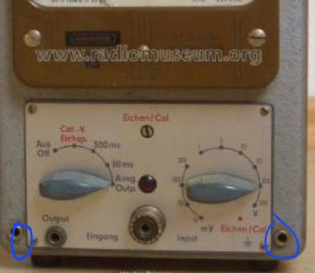

What type connector does this use? I tried a pl-259 and it
Does not work.

Daniel Consales
Hello Mr. Oneill,
I own a Grundig RV11 which has similar connectors. I'm astonished the PL-plug didn't fit - mine does.
Also the description of the TV1 shows "international used rf-connector" which is the PL-259 ...
The manual of the TV1 states that one can use cables with banana plugs (gnd is the right socket (7) ).
Kind regards,
D. Consales
P.S.: when I look at your plug - that seems not to be PL-259 at all

Your PL529 looks like a cheap crimp one. regular ones don't have the tip. I have had cheap PL529 connectors with a poor thread.

Thanks for the help guys. I have a more serious problem. I connected the
Outer probes to a/c and it sparked like an arc welder. Neither side of the
Plug goes to the chassis. What is causing this? Maybe the ports are wrong, i cant read
The german instructions.

These are both ground (there is a mistake in the description, 8 + 9 is the output, but 8 is the gnd, not 9)
Your input should be fed to the center of the coax socket (4mm banana plug) and gnd (7 or 8).

I put a/c voltage to 8 and the center coax, nothing.

Normal operation is in position "300ms" ...
- first before switching on adjust the meter to zero position
- now switch on without any connection to the input. Toggle between "Eichen/cal. V" and "300ms". The reading should be the same in both positions. If it's not you can calibrate that with the screw in the center of the device (4).
- now you can switch to "300ms" and connect your voltage to 6(coax center) + 7

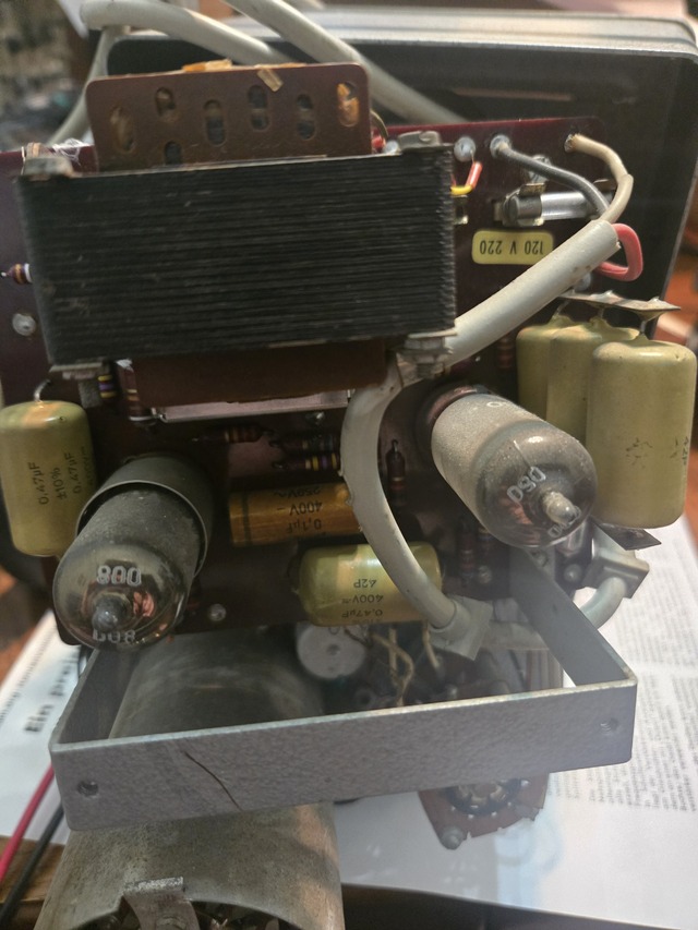

That looks like a polyester cap beside the Electrolytic. They are likelyu OK. Only non-hermetic paper capacitors need replaced wholesale.
The metal can electrolytic caps usually reform if the rubber end hasn't cracked and allowed it to dry out.

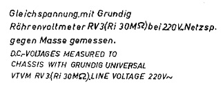

I will check the voltages per the schematic but.....it states on the bottom of the schematic  voltages are with 200v. I am using 120v usa. Is that an issue?

Unless there is a setting for 115V, you'll need a transformer to 220V.
However the model page writes that it also supports 120V.  I also can see the mains transformer has a 120V tap on the input.
Possibly the mains fuse is positioned for 120V or 220V input as I see two fuse holder at the mains cable.
Then the circuit diagram voltages are the same as for 220V mains.

Your fotos show the fuse in position 120V - so the readings have to be the same.

Now i know why americans say stay away from german stuff,
Its a pain to work on. Dont see the selenium rectifier. Hidden
Electrolytics probably are bad. Resistor unknown value
Looks burned. Bulb (good) does not come on, no voltage
But transformer puts out 6.3v. This meter holds a charge
For a long time and shocks.

Looks like the rectifier is right before your eyes - above the burned resistor you showed ;-)
The resistor starts with blue/grey so "68?" so it will be R27 - so no wonder nothing works, the tubes dont get anode voltages.
I can understand your frustration but in my experiences  maintanance on _every_ measuring instrument is a pita regardless of the vendor
P.S.: and it holds the voltage because the failure of the resistor ...

Take out the tubes and the selenium bridge Likely about 1.25" square 1/4" thick aluminium "wafer" with 4 terminals bolted to chassis. Then feed the HT rail from a 30V DC PSU current limited to about 10mA. This will reform the electrolytics. Any Electrolytics where the current doesn't fall to less than 1mA or that are open circuit after 4 hours are faulty.

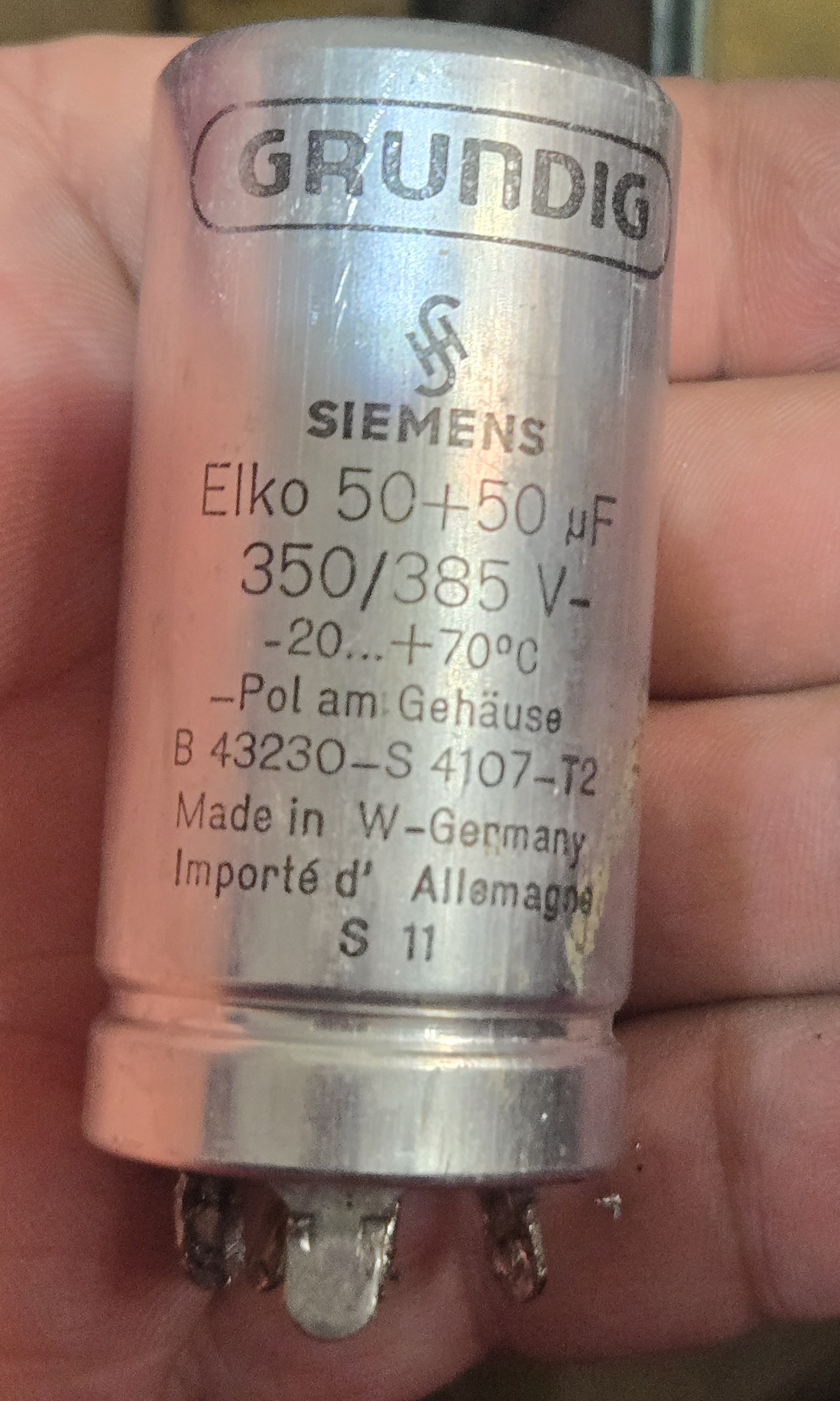

Why did they use huge capacitors in parallel to get 100uf. There are 3
Of them.

Regarding the electrolytic capacitors, its possible that the designers chose to use that type of capacitors because it was cheap and used in large numbers in mass produced radios etc. Maybe a reason for distributing the capacitance in several cans was to increase life of the capacitors by sharing the ripple current between them.
