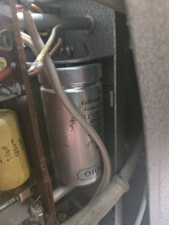

That looks like a polyester cap beside the Electrolytic. They are likelyu OK. Only non-hermetic paper capacitors need replaced wholesale.
The metal can electrolytic caps usually reform if the rubber end hasn't cracked and allowed it to dry out.

I would replace the selenium rectifier with a silicon bridge or 4 x 1N4007. Maybe put 100 Ohms 2.5W in series with either input or + out (which ever is easiest) if HT is too high.
Even if it's working now it will fail.
Check the HT voltages first, then if OK: cathode voltages and anode voltages.
IF HT voltages are all OK
The Cathode voltages being 50% low means the tube is low emission. I'd not worry if 25% low. No cathode voltage means the tube is dead, or socket is faulty as there is no negative supply.

C32 0.1uF on EF86 anode should be examined. Replace if a paper type. The moulded pale mustard capacitors are plastic film and should be fine.

Why did they use huge capacitors in parallel to get 100uf. There are 3
Of them.

Regarding the electrolytic capacitors, its possible that the designers chose to use that type of capacitors because it was cheap and used in large numbers in mass produced radios etc. Maybe a reason for distributing the capacitance in several cans was to increase life of the capacitors by sharing the ripple current between them.
