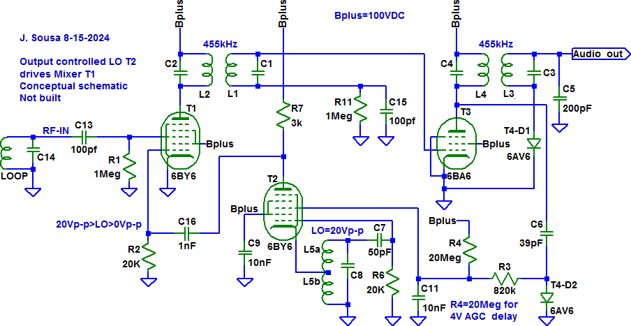

The conceptual schematic below shows the EF94=6AU6 pentode added to a small superhet (Löwe-Opta Kobold 1720w) as the AGC controlled amp between the LO and the Mixer. The sharp cutoff is an advantage to increase the effectiveness of AGC control. Distortion of the LO signal is not an issue at all, as the sinewave overdrive into the mixer is equivalent to a square wave drive.
The LO is the triode section of the ECH81 and generates a typical ~30Vp-p oscillation at its control grid g1t, which would normally be wired directly to the LO injection grid g3h in the ECH81 heptode section.
The usual 50k load resistor at g1t in the LO is now tapped at 7k to deliver only 4Vp-p from the 30Vp-p g1t swing. The 4Vp-p swing is enough to drive the EF94 into cutoff with Vg2=100V. When there is no signal and the AGC voltage contribution is zero at the EF94 congrol grid g1, the peak plate current is 10mA. The 10mAp-p current recreates the 30Vp-p across the 3k load to be driven into the ECH81 mixer input g3h. The 3k load at the plate retains a bandwidth of 10MHz with 5pF of parasitic capacitance at the LO injection input of the mixer.
When a signal is present at the loop antenna, after frequency conversion and amplification, it will be detected by the diode section of the EBF89. The detector yields the audio output as well as the AGC voltage that is low pass filtered by R17=1Meg and C10=0.1uF into a smooth AGC voltage. The 4Vp-p LO sinewave into the EF94 control grid will self-bias the grid to -2VDC. This means the detected AGC voltage will not have any effect until it exceeds this -2V bias. The AGC bias itself also comes with a +1.2V bias from the 100Ω cathode resistor at the EBF89. So, in total, the detected AGC must exceed -3.2V before it has any effect on the gain of the EF94 LO buffer. This is a useful feature and is called AGC delay. This way, no AGC gain reduction takes place until signals are sufficiently large.
Once AGC voltage across R15 exceeds -3.2V, the EF94 will start to be biased off and the peak-to-peak plate swing will start decreasing from the maximum 30Vp-p swing. When about -7.2V of AGC is generated, which translates to -4.2VDC at the EF94 control grid, the EF94 is completely cut off and the injected LO voltage into the ECH81 g3h mixer input drops to zero. Complete cutoff will never be reached because the AGC regulation operates in a feedback loop.
This narrow AGC operating range means that the total maximum possible signal variation when the AGC is active is only from -3.2V to -7.2V. This is an excellent level of compression. Weak stations produce about -1V of AGC and are noisy but listenable. This same circuit operating with conventional AGC controlling the ECH81 and EBF89 remote cutoff grids would have an AGC variation up to -30V, which corresponds to great variations in volume from weak to strong stations.
With conventional AGC controlling remote cutoff tubes, this kind of very tight volume control over a wide range of input signal strenght would have to be done in a larger radio with multiple RF/IF stages under AGC control, or with amplified AGC.
The EF94 is, in effect, also an AGC amplifier, in that it takes a relatively small input AGC swing to control a very wide range of LO amplitude from 30Vp-p to nearly nothing.

The following circuit is only an illustrative sketch of the concept. I did not build it. Various parameters could be adjusted, like the amount of AGC delay, the total AGC range to cutoff or the fixed bias scheme for the RF and IF input grids.
Two Heptodes:
Amplitude controlled Heptode LO drives Heptode mixer
An alternative to the EF94=6AU6 gain controlled LO buffer between the LO and the mixer is a separate amplitude controlled oscillator heptode driving a heptode mixer. This oscillator could be the dual control 6BY6 heptode configured as a conventional fixed amplitude grid/cathode oscillator with the sharp cutoff g3 suppressor grid used to control the level of LO signal delivered to the plate, which then drives the g1 grid of the heptode mixer. The mixer no longer needs a remote cutoff RF input g3 grid. It can be the 6BY6 heptode with a fixed bias at the g3 RF input. The 6BY6 is the sharp cutoff version of the 6BE6.
It would have be determined empirically, which role the g1 vs g3 grids play in the mixer. The schematic shows the recommended configuration for the 6BE6, but this is a 6BY6 with sharp cutoff on both grids. Perhaps injecting the LO at g3 of T1 and the RF at g1 of T1  would yield better maximum conversion transconductance or better AGC compression.
This design also includes a 4V AGC delay with the R4=20Meg pull-up resistor. So AGC action will not start until the detected carrier exceeds -4VDC. This guarantees full maximum sensitivity for all the weaker stations. The value of R3=820k could be reduced to 470k for a 2.5V AGC delay
