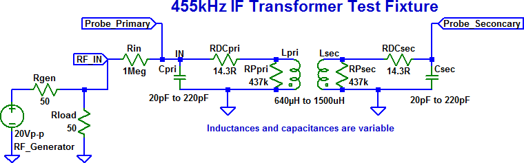

The on the right shows the red alligator clip from the RF sweep generator clipped to a 1Meg resistor that is connected directly to the first tank. This 1Meg resistor does reduce the realizable Q somewhat, but it is also about the same as the plate impedance of an IF amplifier pentode. The 1Meg generator coupling resistor was purposely kept outside the box to avoid coupling through stray capacitance to the secondary circuit. This would distort the secondary response.
The schematic shows the test fixture connections and also a basic model for the tanks with shunt and series resistance losses. The series resistance in this case is just the DC resistance. Any series AC losses caused by skin effect are lumped into the shunt resistance.

The primary and secondary inductance is always nominally the same in all the sweeps.
The first plot below on the left shows the response of the primary tank with the secondary tank completely detuned to a high frequency. The 7.6kHz bandwidth indicates a Q=455/7.6=60 when the tank core is in far enough into the coil to get 1.4mH. The Q will be lower with lower inductances because the series losses increase with the increased resonating capacitance.
The second plot shows the original response of the transformer after alignment with the internal 125pF mica disc capacitors. The resulting inductance after alignment at 455kHz was 970uH. Not surprisingly, an undercoupled response is seen at the secondary in the blue trace, but the coupling still widens the overall transformer response to 9.25kHz bandwidth, as compared to the bandwidth of a single tank. The primary tank response shows the dip that is caused by the secondary loading at resonance. The loaded response of the primary is now much wider than without the secondary tank load. This illustrates the fundamental difference between AM-IF strips with coupled resonant tanks in tube designs with single tanks with taps or untuned secondaries that are common in transistor designs. A coupled pair of tanks gives a wider passband response than a sequence of two uncoupled tanks over two stages.
