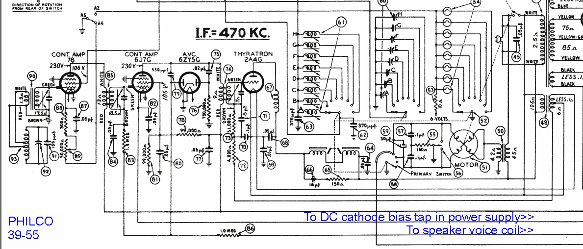

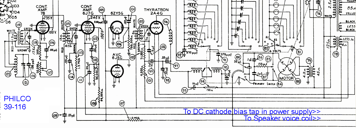

Yesterday, I got to see Ron Roscoe's Philco 39-116 receiver working with the Mystery remote after the 2A4G Thyratron was replaced. The original Thyratron was defective and was constantly on.
I think we also figured out the function of the 6ZY5 rectifier in the AGC circuit.
One significant difference between this 6YZ5 rectifier circuit and the diode connected 6J5 circuit, is the value of the coupling cap, which is 550pF for the 6J5 and 0.02uF driving the plates of the 6ZY5.
When the 6ZY5 is pulled out, the remote pulse counting becomes erratic, and the RF burst driving the grid has an envelope that shows a large overshoot, and rapidly decays to the AGC controlled envelope amplitude. The job of the 6ZY5 is to clip the start of the pulses until AGC action takes over with complementary time constants. This test was done at close range, to get AGC action.
The remote reception seemed unaffected when the 6J5 AGC detector was pulled out. Again, checked at close range.
(By the way, Ron's house was built over a concrete slab with steel reinforcement. He may get more range by lifting the receiver loop off the floor. This may also detune the loop. He demonstrated to me a range of about 5m over the concrete floor. The remote control receiving loop lays horizontal occuppying the entire bottom of the cabinet, and sits no more than 6"=15cm above the floor)
As I look at the time constants for the two AGC circuits, it becomes apparent that a pulse rate bandpass filter action is bounded between the high cut of the 6YZ5 with a 15ms time constant (10Hz) set by 104 and 106, and the low cut of the 6J5 with a 75ms time constant (2Hz) set by 113 114.
Ron's radio is the Philco 39-116, but if you look at the Philco 39-55, there is no 6J5, and the two detector functions of conventional AGC and suppression of AGC action overshoot, are performed by each plate of the 6YZ5.
The 6J5 in the 39-116 represents a clear case of tube count inflation over the equally effective 39-55 design.
The 1Meg resistor 107 in the 39-116, and 86 in the 39-55, going back to the speaker voice coil can also add any negative noise spikes present at the coil to increase AGC action in the Mystery control receiver. The phase of the speaker connection must be correct for the burst envelope to be represented by a negative spike.
The Mystery remote control signal remains as an RF burst right up to the Thyratron grid. This grid is normally kept off with approximately 20V p-p AC that is out of phase with the plate. When the plate is positive, the grid is negative. The RC network at the grid, also forms a grid leak circuit that converts the 20Vp-p AC from the thirt tap at the filament transformer, into a 0 to -20V swing. When the RF burst is applied, it is added in series with this voltage by RF transformer 103 in the 39-116 and 74 in the 39-55, and the positive peaks of the RF burst fire the thyratron grid.
-Joe
