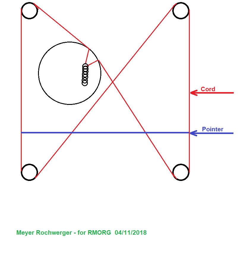

I have PYE G PE40 set and is restored, unfortunately before I could note down Dial Cord routing details, the thread came off, I am trying to re-cord the thread,but some where i missing some thing,
Any one can help me by advising the routing the dial cord properly? It is verticle dial

This radio employs two types of bead on the dial.
One is to move the variable capacitor wheel.
The other moves the pointer. Let's call it "main cord"
Attached is a simple drawing of the "main cord".
** Sorry for my rough design
Hope that helps.

Dear Sir,
Greetings !
Thank you so much for the diagram, Now I will work on it.
