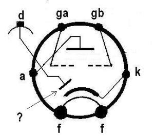

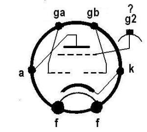

  1. The internal location of the additional grid (or plate) of the “Wunderlich-B”
Some sources talking about  ....an entirely separate diode plate was added...” (J.W. Stokes)
Others see a “... separate grid near the anode” What is the truth?
                                 Layout 3
                              Layout 4

Well, simply stated, Mr. Holtmann's Layouts 2 and 4 are correct.
Verification of Layout 2 comes from a pair of Arcturus brochures
in-file here (thank you, Jim Cross!).
Verification of Layout 4 comes from an article on the Wunderlich
B by Ed Lyon in "Radio Age" (Mid-Atlantic Antique Radio Club) for
Jan. 2000.  The sainted Stokes was correct:  there is indeed an
extra plate!

The basing diagram for the Wunderlich B is US diagram 6P, which is
given on the linked message as "layout 3"
Pin 1 - heater
Pin 2 - anode
Pin 3 - grid
Pin 4 - grid
Pin 5 - cathode
Pin 6 - heater
Cap - "anode grid"
Somewhere I have a 1930s article showing a "B", and I am pretty sure
the extra element is above the regular grid-plate structure, and that
the extra element acts as a diode.

Having regard to both reactions, I see a confirmation of layouts 2 and 4.
Furthermore to the so called "anode grid", in fact it acts as a diode and has nothing to do with the main anode construction. May be, that it was built as a grid around the cathode rather then a plate.
As a result of this, I will correct our internal presentation about these tube types accordingly.
