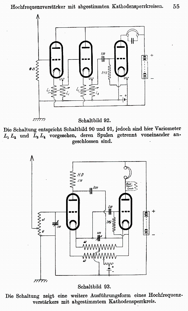

Circuit diagram 92
The circuit corresponds to circuit diagram 90 and 91, but here variometers L1L2 and L3L4 are provided, the coils of which are connected separately from one another.
Circuit diagram 93
The circuit shows a further embodiment of a high-frequency amplifier with a tuned cathode notch.

Figure 92 (Schaltbild 92) replaces the tuned tanks at the cathodes with variable inductances. At best, with large inductance values, the two cathode follower stages have a combined voltage gain of 0.8=0.9*0.9. As shown the circuit presents no explicit resonant circuit. But the version in the Lübben article above in figure 5 (Abb. 5) shows a tuned antenna circuit.
Figure 93 (Schaltbild 93) The operation of this circuit is not obvious with the explicit feedforward or feedback path from the plate of the first tube to the cathode of the second tube. This is plausibly a cathode follower circuit with regenerative feedback. Some experimentation with circuit simulation with LTspice could reveal the characterstics of the circuit.
