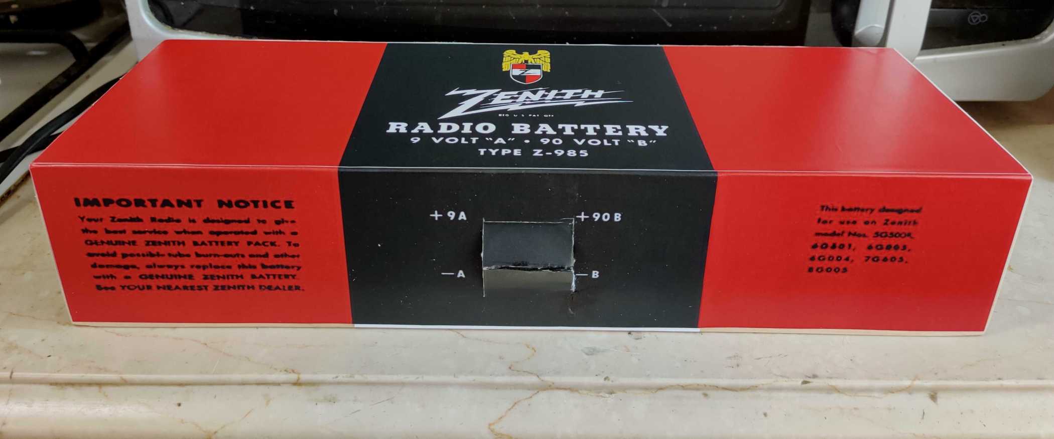

This pack shows a somewhat baroque series/parallel switching method for a 90V pack in a Zenith Trans-oceanic G500. The series/parallel switch is made from individual DPDT slide switches soldered together. A stiff wire runs through the plastic sliders. It works, but is a bit stiff. I used standard 6xD battery holder for the filament voltage. Both packs connect to the original 4 pin socket with an improvised 4-pin plug. The design of the battery wiring in this radio is a bit peculiar. It is possible to blow open one of the filaments if the batteries are not all connected together. When changing batteries, make sure the power is off, and the 4pin plug is disconnected.

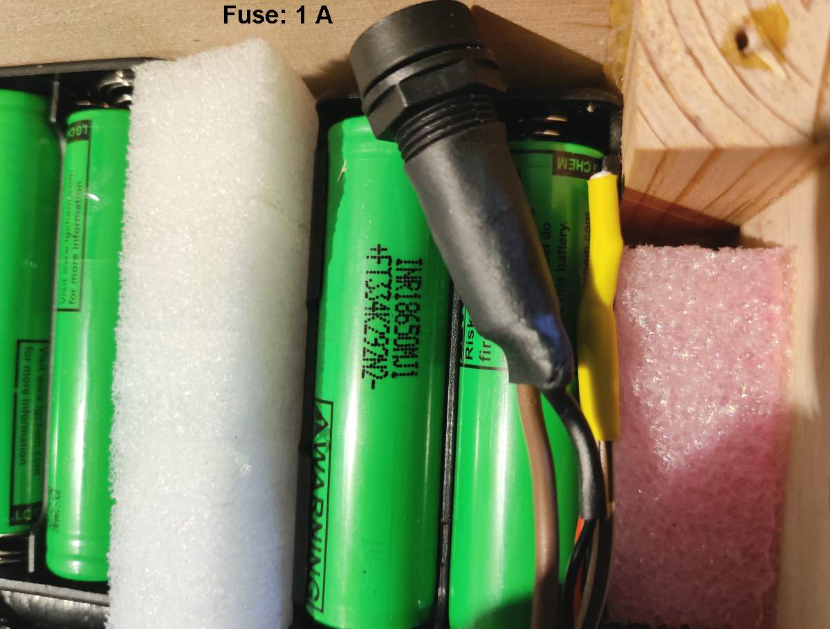

I always add fuses to NiMH packs made with AA size or larger. The 9V sizes don't store enough energy to cause a fire with a short with a 20 AWG wire. However, when several 9V cells are wired in parallel for charging as recommended above, a fuse in series with the shunt charging combination is necessary. I used a microfuse in the PCB shunt/series plugs. Some experimentation could be done to see if there is series combination of 9V NiMH cells that could over-heat a wire short.
My favorite positive tempco resistors, that also serve as fuses, are light bulbs. But these can't be applied with the same reasoning as fuses because the current levels that take advantage of the positive tempco are much lower than the current that would burn out the bulb. Nevertheless, when applied correctly, lightbulbs can be effective protectors. You see at least one light bulb used as ballast in the circuits above.
I have used light bulbs in series with low voltage packs or power supplies, with a bulb voltage and current rating that simply results in the lightbulb lighting up normally when there is a short. This works when the expected load current is much less than the bulb current rating.

A realized Zenith Z-985 AB, replica.

Very nice pack, Sandor! The charge should last a good long time too.
I would strongly recommend including fuses inside the battery box in series with all external power wires to prevent a fire in case of an accidental short.

Hi Joe!
Fuse ok, see!  :)
 18
