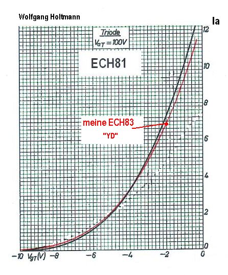

Wolfgang Holtmann
As Mr. Konrad Birkner already suggested,
I made a direct comparison between the ECH81 and ECH83, both with the “YD” code. To keep it simple, only the triode section was tested.
The plots of the static transfer characteristic was used as reference.
To be sure my own ECH83 (Philips) is in good condition, the red trace is quite nicely in shape with the Philips publication. Test voltage was 25 V. See below.
The next step was to compare the behaviour of the very same ECH83 at Va = 100 V, as given for the ECH81.
Again, almost no difference in the transfer characteristic of my ECH83 in comparison with the ECH81 data is visible.

We saw in the past:
n      ECH83 and ECH81 with the same coding “YD”
n      Even the Production Change (Revision) Code “YD D” is sometimes equal
n      No great difference in system geometry between the Philips make ECH83/81
n      The characteristics are (nearly) equal *)
n      It turned out, the ECH83 has in fact no lower Vmax limitations
*) Several ECH81’s (NIB) are checked (plot of the Ia-Vg curve, Heptode and Triode section separately tested) against the ECH83’s factory statements.
My results: equal or even better current flow at 12.6 volts !!
The proof of the pudding….
Up to now we didn’t make a functional test under real receiving conditions! This ultimate test would prove, whether the hf-qualities between the ECH83 and ECH81 are equal too?
Suddenly I remember some experiments done with a breadboard mixer-circuitry a few years ago. The goal was to test the electrical performance of “Ersatz” vintage mixer-tubes difficult to find.
In the Philips Data Sheets I discovered a test circuitry around the ECH83:
With some minor modifications I tested all my ECH83’s and ECH81’s at 12.6 V and 6.3 V using the schematic as shown below:
The IF-output signal (470 kHz) is fed to a Selective AC-Voltmeter tuned to that frequency. At 6.3 V the output signal is 4.5 dB lower.
Conclusions:
No significant difference in the ECH81’s hf-performance in relation with the ECH83’s !
Believe it or believe it not, even with the supply voltage reduced to 3 V both tube types are still functional!
