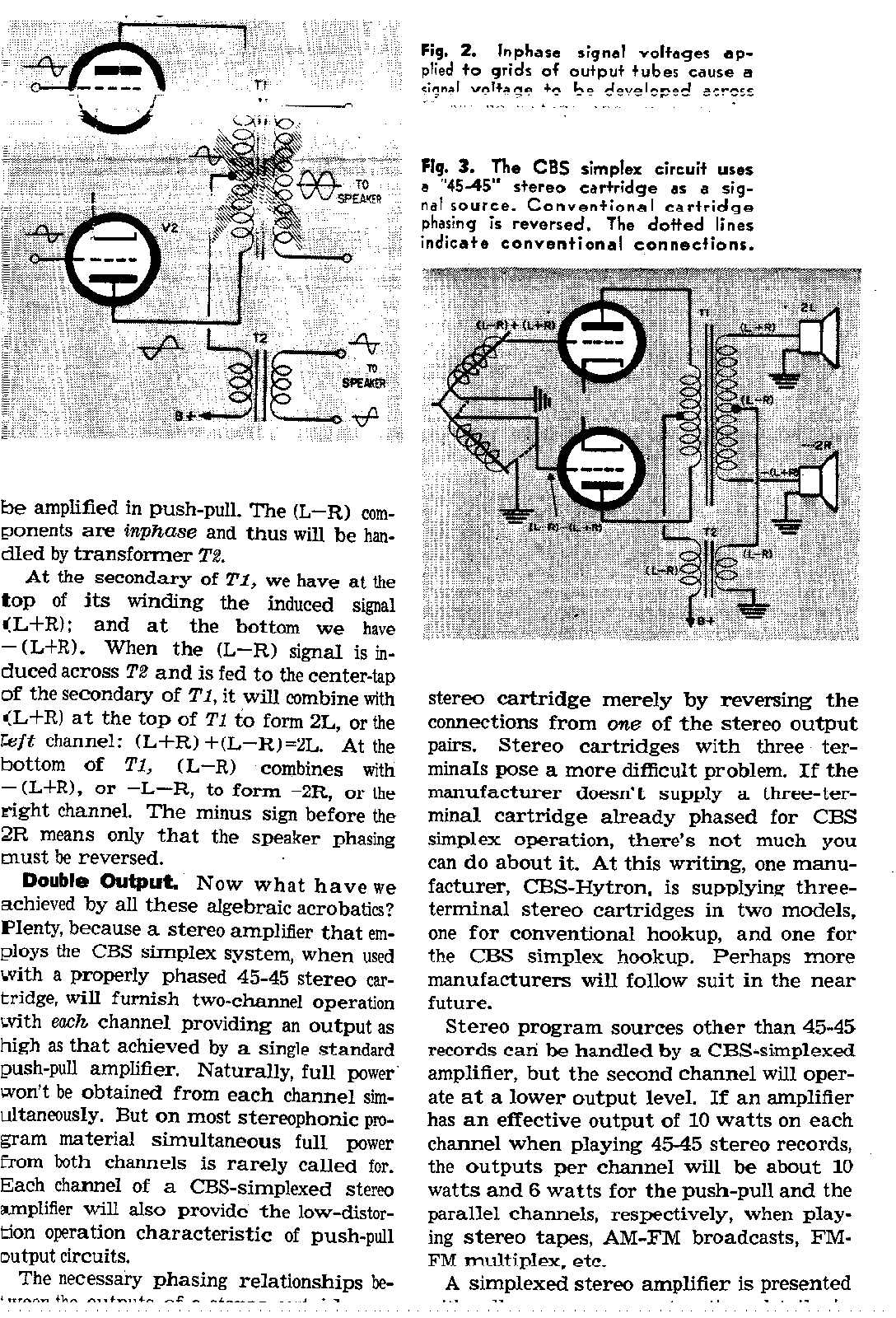

One fine point about the alignment of the first IF transformer in the One-tube Superhet at the start of the thread:
The plate balance trim caps are adjusted for maximum rejectioin of the common mode IF signal that is injected at the control grid. One way to state the alignment requirement is that the Common mode rejection must be deeper than the IF (common mode) gain from the control grid. If the Common mode rejection is not deep enough, IF oscillations will result.

The concept of amplifying independent signals in a common mode path and in a differential path was used as a way to implement stereo amplification in a basically mono amplfier structure. I attached an example of this principle, called Stereo Simplex by CBS.
